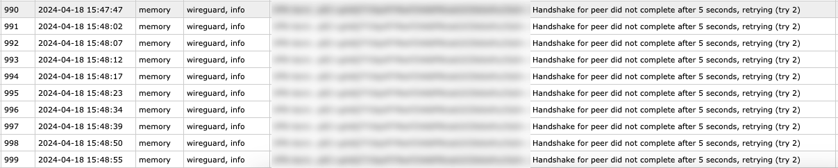

But it seems still not fixed in 7.14.2,when i disconnect from my android phone,the router will log a lot of “Handshake for peer did not complete after 5 seconds,retrying (try 2)” message.

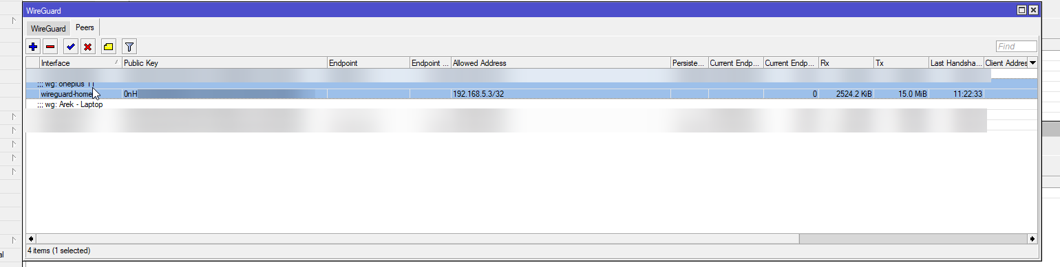

Nope, neither endpoint nor keepalived persistant is enabled on mikrotik server, yet it still tries to handshake in loop once device was online for a while.
https://ss.codeone.pl/ss-2024-04-05-10-14-55-1712304895-Hzo6SuR2.png
https://ss.codeone.pl/ss-2024-04-05-10-15-57-1712304957-jMmCVhNo.png
