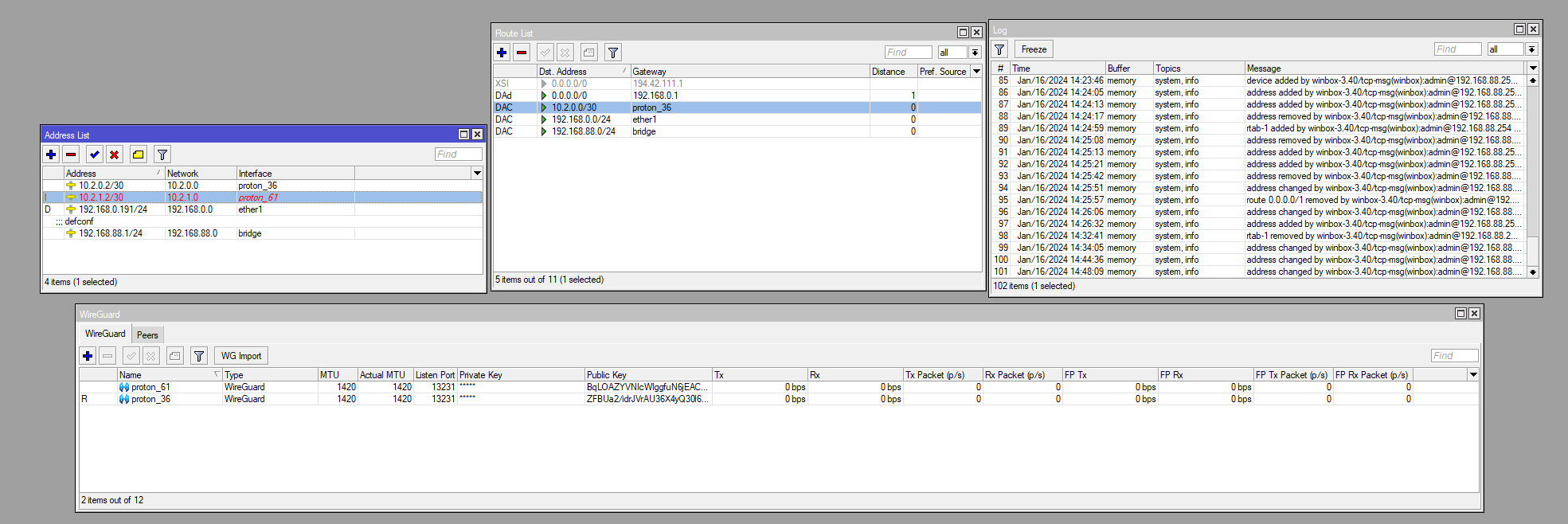

Hi, I want to configure routeros to connect as a wireguard client to two servers simultaneously. I am using some VPN service provider out there (like mullvad or surfshark. Doesn’t matter) and I want it to have a connection to two servers in different locations at the same time. I generate separate connection keys at the vpn provider, but I have a problem configuring wireguard in routeros.
I am able to configure one connection correctly, but when I create the configuration for the second server I have a problem.
The problem appears in the IP/address list where the second address gets the invalid parameter (screenshoot 1).
At first I thought it was because the ip’s (which are set by the vpn provider) are the same, but even when I change them to different ones (see screenshot 2) it has paramert invalid.
Do you have any ideas what I should change to set this?

As you can see in the second attachment even when the IPs are different, it continues to be marked invalid, but I don’t know for what reason. Also, the IP for the WG client forces me to have a vpn provider, in the one I use every client (in the config file I download from it) has the same IP.
Every local WireGuard interface should use its own port. You assigned same port to both interface, this is the error. Change one of them to a new port.

The ListenPort is the same for all peer connections or is that wrong? I did find another reference to my issue with the following explanation that I am not sue about with regard to the IP mask. The instructins I have found say to set the MASK to /24.

Outbound is problem, if each wg peer setting to the third party provider is 0.0.0.0/0 for allowed IPs, then it wont work.
By having a different interface and different port, the problem is avoided.
