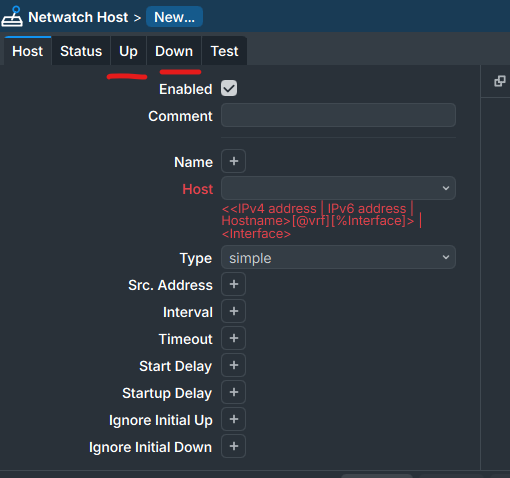

Yes, or check in netwatch script if you can ping other side of the tunnel.
If not, then in "Down" section disable/enable ( restart) the needed services or interfaces.
