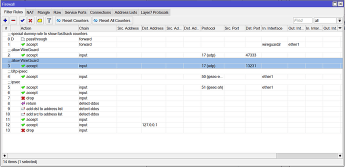

no i can’t ping 192.168.1.1..
so this is my firewall rule
ip firewall filter
add action=accept chain=forward in-interface=wireguard2 out-interface=ether1
add action=accept chain=input comment=“allow WireGuard” dst-port=47333
protocol=udp
add action=accept chain=input comment=“allow WireGuard” dst-port=13231
protocol=udp
add action=accept chain=input comment=l2tp-ipsec in-interface=ether1 protocol=
ipsec-esp
add action=accept chain=input comment=ipsec in-interface=ether1 protocol=
ipsec-ah
add action=accept chain=input connection-state=established,related,untracked
add action=drop chain=input connection-state=invalid
add action=return chain=detect-ddos dst-limit=32,32,src-and-dst-addresses/10s
add action=add-dst-to-address-list address-list=ddos-target
address-list-timeout=10m chain=detect-ddos
add action=add-src-to-address-list address-list=ddos-attackers
add action=accept chain=input dst-address=127.0.0.1
What is this supposed to do ? Adapt this rule, remove the “out-interface” critera to start.
You have a generic “masquerading” rule that will NAT everything going out via “ether1” , so I don’t understand why the above rule is needed.
Did this rule ever had any hits ?
Now, on the DNS part => 192.168.1.1 = Mikrotik “interface” itself (on which you want DNS resolving)
Hence you must have on your INPUT-chain a rule allowing that! Try to add the rule in bold allowing traffic from the wireguard2 interface to “hit” your Mikrotik interface(s)

Retest that ping ?
Your firewall rules are pratically non-existant and thus should SHOULD pass everything through. This is a blind terrible approach.
The better approach is to use the deafult rule set with drop rules at the end of both input chain and forward chain. In that regard you know exactly what is allowed and everything else is dropped.
Much clearer and cleaner. (aka get rid of the disorganized noise you have)
