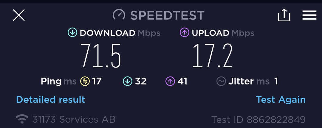

Since changing the MSS seting I am now “connected” through SurfShark and can browse the web, however the “upload” portion appears to be broken; speed tests indicate that my upload speed is 0Mbps and if I watch the WireGuard interface during a speedtest my Tx rate sits at 6-15Kbps.
I have noticed that the only way I can get my upload speed back to normal is by adding a routing rule for the destination address of my WG provider clients subnet to use the main routing table:
dst-address=192.168.5.0/24 action=lookup-only-in-table table=main
The problem is that I’m not exactly sure what this is doing or why it’s affecting (or alleviating) the upload issue, or whether this is actually instead allowing my upload traffic to bypass the WireGuard tunnel. Again, this wasn’t at all necessary with Mullvad.
Surely I shouldn’t need anything like this with srcnat?!
Both NordLynx and SurfShark work absolutely fine with the WireGuard Android app using identical interface / peer configs as the router, yet not with my configuration on my Mikrotik Router.
Can anybody help me with troubleshooting what exactly is going on here? I’d really appreciate it.

OK - Just successfully finished my first Netinstall with a PCI-e network adapter I found laying around as it flat-out refused to work with my onboard NICs. Sad news is the problem remains.
Mullvad:
Surshark:
