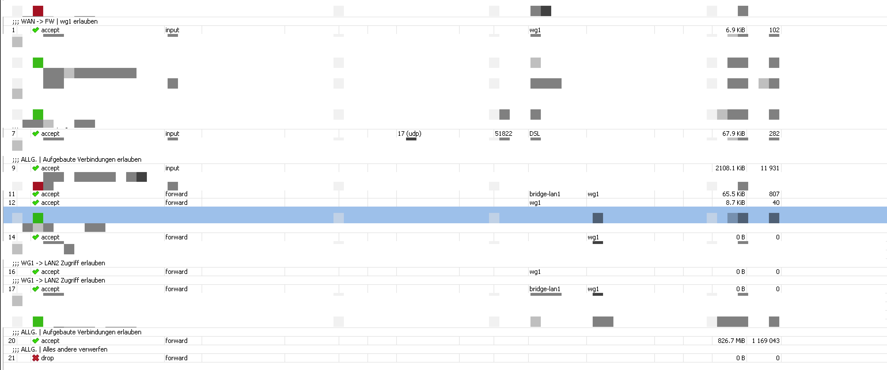

I set up the route for the wg net (18.1.1.4/30 and the network of the other location) with the wg1 interface on my mikrotik.
So i setup a few firewall rules to allow the wg1 interface to connect into my routeros and same for connections out of my routeros.

Yes.
First, diagrams less helpful than full config
/export file=anynameyouwish ( minus router serial number and any public WANIP information or keys etc.)
  1. Confirm the MT device acts as the client for the handshake, it would appear so.
  2. What is at the other end of the tunnel, another MT acting as server? Third party VPN provider?
  3. if not a 3rd party VPN do you have access/control over the config at the other end?
If MT, would need to see config as well.
If not MT, would need to see the wireguard settings regardless of type of server at other end.
Hiding critical parts ? What’s secret on some private IP address used, except that it is imperative these ranges are 100% correct ?!
Export config’s and hide only sensitive private information, but not the config details around wireguard IP, and routes.
Your route for the remote 192.168 subnet is wrong. Use the remote WireGuard IP Address not the interface wg1 for the route destination.
That’s not it. You can use IP address as gateway, but WG doesn’t really care, it decides itself where to send packets, based on peers’ allowed-address.
E.g. if you’d have WG interface with 10.0.0.1/24 and two peers:
  • peer1, allowed addresses 10.0.0.2, 192.168.2.0/24
  • peer2, allowed addresses 10.0.0.3, 192.168.3.0/24
and you’d add route to 192.168.2.0/24 with (wrong) gateway 10.0.0.3 (address belongs to peer2), packets to 192.168.2.x would still go correctly to peer1.
