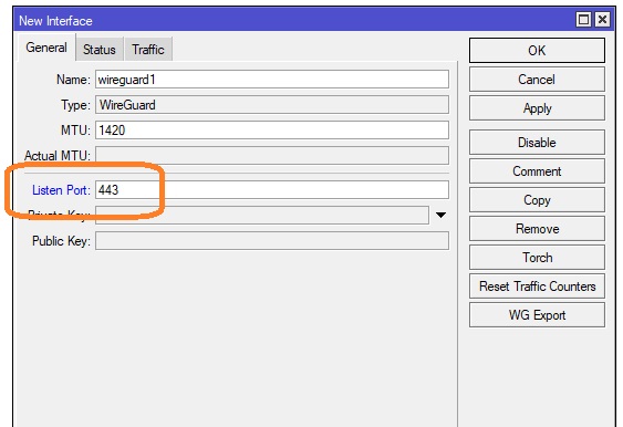

Regarding the performance - I will alway go with WG, however if the IPS is blocking the ports, then OVPN is better solution, as no one is blocking 443.

For some reason that will not work.
I’ve tested today, OVPN does.
i’m connected to public internet(hotspot), where all the ports have been disabled except 443

Is your OVPN server running on TCP? Wireguard works only on UDP. If such is the case, hotspot is probably allowing only TCP 443 connections.
Sounds like a personal problem, no reason why 443 UDP should not work, unless its a company that restricts ports…
It seems it is browse-web-only public hotspot on which even QUIC is not supported :slight_smile: Btw, it is possible to tunnel WG over TCP, but requires tunneling tool in container and client side…

im not asking for a help , all i’m saying is that you can’t use WG in any situation.
If the IPS is blocking the ports , and even if you play with 433 that will not help to establish connections. Not sure why is that,
So in this case you have to use OVPN
Are you stating that on the same port and with same protocol OpenVPN will work while Wireguard does (sometimes) not?
