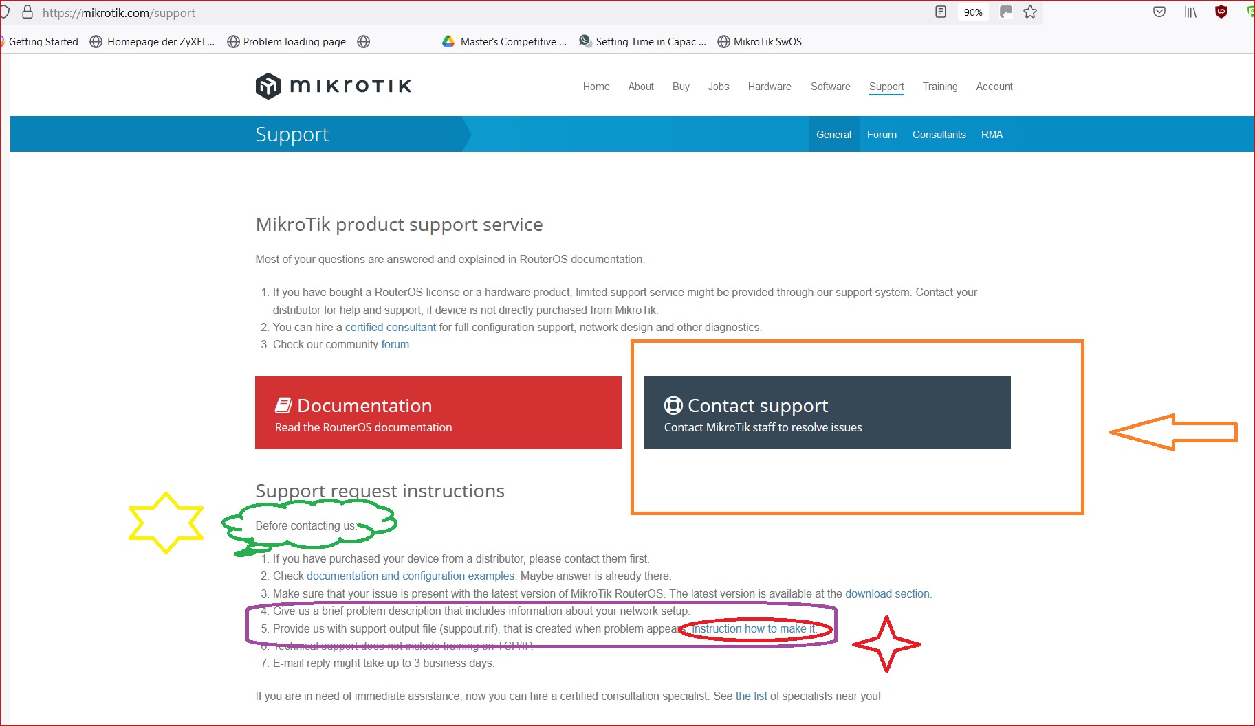

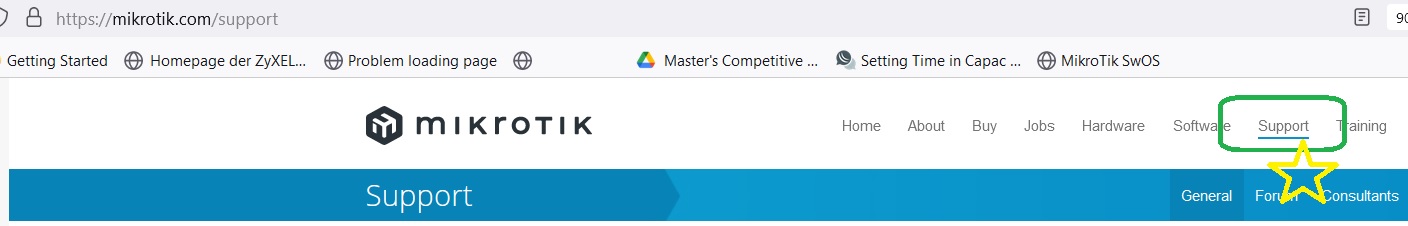

How could I report the bug?
Kind regards.
zorrua, its terribly complicated and found only on the dark web, its a wonder anyone can find it…
The link for the instructions brings you here, if its not clear its a link.
https://wiki.mikrotik.com/wiki/Manual:Support_Output_File
the newer site.
https://help.mikrotik.com/docs/display/ROS/Supout.rif
