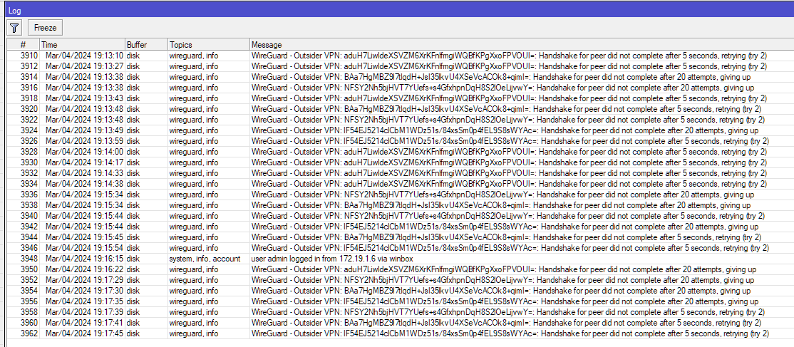

For me everything fell apart with 7.14 as well, mainly Mikrotik router ↔ Mikrotik router Wireguard VPN connections. Windows → Mikrotik router Wireguard VPN seemingly works.
This is what it looks like in the logs:

I have three WireGuard links on my RB750Gr3 and found yesterday that one of them is down with the same errors in the logs like yours @masterhrck.
It looks like after upgrade on this particular VPN link Public and Private keys have been replaced with different keys I don’t know about. They still looks like a keys but not mine. Either a bug or maybe MikroTik has “secret” code contributor inaptly trying to take control over MikroTik routers.
