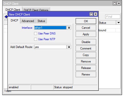

Thank you @anav, your replies helped me figure out my issue.
I got too hung up on the automatic dhcp-client config. As soon as I configured this explicitly, I was able to configure my default route. The only other thing that I needed to do was to add an explicit route for the WireGuard endpoint, so that the default route would work correctly, i.e. :

Here is a high-level summary of the steps required to get this working with a wired connection to the hotel’s access point:
  1. Configure WireGuard
  2. Configure 5GHz radio as an access point
  3. Configure ether1 dhcp-client before plugging anything in. Disable Peer DNS, Peer NTP & do not add default route.
  4. Add explicit route via DHCP gateway IP for the WireGuard public endpoint route (see config example above)
  5. Route all traffic via WireGuard interface (see config example above)

/ip dhcp-client
add add-default-route=no interface=ether1
