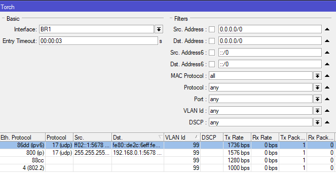

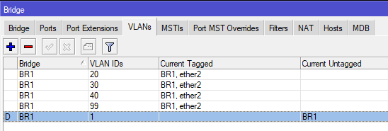

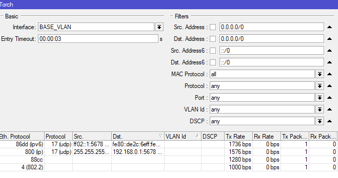

I have reconfigured Router from the scratch to make sure that VLAN’s are working according to scematic diagram ( No WG this time just to make sure VALN is working before WG) and having the problem with local internet access:
  • On the local PC: I can ping VLAN and DNS server on the 192.168.0.1 IP address
  • On the local PC: “nslookup google.com 192.168.0.1” giving response : “Server: UnKnown Address: 192.168.0.1 Non-authoritative answer: Name: google.com Addresses: 209.85.203.113 209.85.203.139 209.85.203.101 209.85.203.138 209.85.203.102 209.85.203.100” , showing that DNS server at 192.168.0.1 can resolve
  • On the local PC: “ping www.google.com” from the local network giving no response with packets received = 0
  • On MikroTik router : able to successfully ping the Google DNS server .
Possibly there are some there is a firewall rule blocking the traffic, so I have disabled all Drop rules in firewall in case if they causing any problem …
To narrow down the problem with Internet I’m still using Mac server alone even it is not a secure access method.
