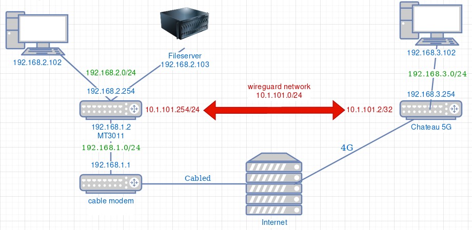

A clear network diagram showing the routers, the internet connection, and where the computers sit on the diagram (and the IPs) etc will help.
Just use fake numbers for actual WANIP numbers.
OK, sorry for the delay, have been travelling and now I’m at the remote place where it is easier to do the complete management. I’ve also replaced some hardware so things may be a bit more straight forward, but still I’m not able to get all bits together. I’ve replaced the remote hardware by a MikroTik Chateau 5G.
The current diagram is:
From within the Mikrotik routers I can ping and traceroute all devices on the 10.1.101.0/24 network, at least I can ping in two directions between 10.1.101.254 and 10.1.101.2. On both the wireguard stations I’ve added routes for the distant networks (192.168.2.0/24 and 192.168.3.0/24) pointing to the wg_home interface but still devices on these networks are not accessible. For instance I would expect to be able to ping from 192.168.3.102 to 192.168.2.103,
What I want to achieve is to be able to access services (ssh, smb, https, etc) from each side of the wireguard network to the other.
I guess I’m still doing something wrong in routing and the firewalls and hope some can help me out…

Your setup make no sense to me.
Firstly the R3011 has no public IP address it gets a private IP and thus you have a modem/router in front of it not a modem.
Can you forward a port on your Modem/Router?? Can you add routes??
Also you didnt read a thing I wrote, wireguard is not a TCP protocol and yet
you didnt remove the line from the RB3011…
  1. All required ports from the (publicly available) cable modem are forwarded to the RB3011 router. I have not chosen to create a DMZ but just to forward all ports I need from the modem to 192.168.1.2 (RB3011), like 80, 22, 443, etc. The public address of the router is fixed (or available anyway via my dyndns account).
  2. The tcp protocol on 13231 port is, after advise of someone else on this forum, made available for winbox access (it’s in the /ip service line of the RB3011). Actually I moved the wireguard port to 13232 (which is actually also forwarded by the modem to RB3011)so I guess for solving my wireguard problem this port/protocol is not interfering in this process
And of course, I fully agree, it will only make sense when it works, and that’s exactly why I’m reaching out to the forum… :smiley:
Who in the forum stated you needed TCP port for wireguard settings?? Will look at the rest later.
The advise was not for wireguard but for winbox and in the context of wireguard (as being more safe). Sure, currently it makes no sense for wireguard but I still need it to be able to access my router. But is it in the way of my current wireguard setup?
I’ve made some progress, where now I have full access from the right of the scheme to the left. Can access both the router (MT3011) and all devices behind the router using their local IP (in the rang of 192.168.2.0/24).
From left to right it still is not fully functional. I can access and fully control the CH5G router at the left sided using it’s Wireguard IP address (10.1.101.2). But the network behind the router (192.168.3.0/24) is not accessible (by ping, or any other service). In the router at the left I’ve defined a route (192.168.3.0/24 to wg_home, which is the WG-interface) and I tried a route 192.168.3.0/4 to 1.1.101.2 (the WG ip address of the router at the right of the scheme). But neither of both options work.
Besides the Mikrotik modem at the right side, I also have another remote device behind a 4G network, which behaves the same (can access the left side of the scheme but cannot be accessed)
I must mis something in the routing or firewall but can’t get any further.
Full configs of both units minus any public WANIP info please.

Config RIGHT side
# aug/28/2022 22:06:05 by RouterOS 7.2.1

(1) One should not leave the WINBOX port exposed to the internet.
add action=accept chain=input comment=“Winbox (13231)” dst-port=13231 protocol=tcp
Winbox needs only to be available to
a. specific LAN users
b. specific vpn users after the arrive in the router!
Since you dont have a block rule from LAN to WAN, you dont need any rule here so simply remove it.
LAN users by this rule will be able to access winbox.
add action=drop chain=input comment=“defconf: drop all not coming from LAN” in-interface-list=!LAN
If you have vpn users that need access to winbox then make another input rule before the !LAN rule, where you specifically note an in-interface on the router or src-address valid within the router.
add action=accept chain=input in-interface=vpn-interface-name ( or src-address of VPN user) dst-address=winboxport protocol=tcp
(2) Your IP Route to the subnet at the remote router 192.168.3.0/24 is good, however go back to wireguard peer settings for this remote chateau…
/interface wireguard peers
add allowed-address=10.1.101.2/32,Missing comment=“WG-home” endpoint-port=13232 interface=wg_home
public-key=“xNkR…”
needs to be
add allowed-address=10.1.101.2/32,192.168.3.0/24 comment=“WG-home” endpoint-port=13232 interface=wg_home
public-key=“xNkR…”
RIGHT SIDE ROUTER
(1) This rule makes no sense on the input chain, if anything it would be forward chain rule.… Remember the wireguard interface is like parallel to the LAN in location.
add action=drop chain=input comment=“GUEST: Block all from guest to wg_home VPN” dst-address=
10.1.101.0/24 in-interface=bridge_guest log=yes log-prefix=FTWtest-log
(2) Same idea with this rule…
add action=drop chain=input comment=“GUEST: Block all from guest to local network” dst-address=
192.168.0.0/16 in-interface=bridge_guest log=yes log-prefix=FTWtest-log
(3) I have no clue what you are trying to do here…
add action=drop chain=input comment=“GUEST: Block all from guest to router webinterface”
connection-state=invalid,established,related,new,untracked dst-address=10.1.1.254 dst-port=
21,22,23,80,443,8728,8729 in-interface=bridge_guest log=yes log-prefix=FTWtest-log protocol=tcp
(4) What is not clear is the discrepancy in routes and allowed peers to the left side router.
One would think that you wanted internet access by the use 0.0.0.0/0 which by the way will also include the subnet and the wg interface IP of the left side as well so three birds one rule..
However you have no routing to tell the Right Side subnet to go out the wireguard tunnel for internet.
So which is it.
a. bad allowed peers setting (should be wireguard IP of left side, and subnet of left side) OR
b. missing routing for internet to force users out tunnel.
OK, @anav, this did the trick. I had, as you suggested, to add the subnets of the local subnets of the various routers to the AllowedIPs-section. This was not clear to me from the manuals of Wireguard and Mikrotik.
The setup is:
Router A is connected to the wireguard subnet with a fixed IP (A.wg) and has 1 other subnet (A.s1)
Router B is connected to the wireguard subnet with a fixed ip (B.wg) and has 2 other subnets (B.s1 and B.s2)
Router C is connected to the wireguard subnet with a fixed ip (C.wg) and has 1 other subnet (C.s1)
So what I did finally is the following:
In A the AllowedIPs are set for the A.wg/32 AND for A.s1/24
In B the AllowedIPs are set for the B.wg/32 AND for B.s1/24 abd B.s2/24
In C the AllowedIPs are set for the C.wg/32 AND for C.s1/24
In A the routes are defined to B.s1/24->B.wg, B.s2/24->B.wg and C.s1/24->C.wg
In B the routes are defiend to A.s1/24->A.wg and C.s1/24->C.wg
In C the routes are defined to B.s1/24->B.wg, B.s2/24->B.wg and A.s1/24->A.wg
I’ll let the discussion about the other wg-principals and firewall settings alone here, they were work in progress and not part of my question.
Thanks for the help!
Sorry mike, I should have given you the link to the New Testament - https://forum.mikrotik.com/viewtopic.php?t=182340
Remember if you remember anything, is that Allowed IPs you put on the local router always concern the remote device.
a. local users originating traffic on the local router need to reach a remote subnet ( that remote subnet is the subnet you put in allowed IPs).
The local router when seeing a destination address checks if such a subnet is identified in all peer addresses and then matches the right subnet to the first peer in the order that contains that subnet (and thus the correct routing will be determined. (Matching/ Selection process)
b. remote users originating traffic on the remote device are reaching the local router and wish to exit the tunnel. (The remote users subnet is the subnet you need to put in allowed IPs)
The local router will see remote traffic attempting to exit the tunnel, the router will consult the peer lists to ensure those source addresses are allowed to exit the tunnel and enter the router ( sorta parallel to the LAN).
c. You always should put the wireguard IP address of the remote peer as an allowed IP, especially the hub, the spokes ( such as road warriors or other mt routers that are not like a hub, )normally put the subnet of the wireguard network which allows them to easily ping the other spokes of the wheel so to speak.
d. If a local subnet on the local router needs access at a peer, then the remote address is 0.0.0.0/0 and this will include any remote subnets they may need to visit as well as the peer wg address.
Thanks @anav for your patience and explanations. Especially the link to your New Testament explained a lot of the background. I have now exactly what I what: a public accessible router (Mikrotik on which only the udp port for the wireguard port is open) and two routers (one Mikrotik, one Olimex-lime2-based router) behind natted networks. All registered clients (laptops, android devices, etc) can communicate to all devices behind the various subnets and all guest clients they can only access internet (all routes to local subnet, wireguard and router interfaces are blocked). Also all Mikrotik management is done through the wireguard network.
My confusion was about the AllowedIPs, which indeed, as you have pointed out, are only the REMOTE subnet-IP’s (or ranges) from and to which trafic can be initiated. And they need to be defined at both ends of the wireguard network (meaning the routers). And also important, for each trafic route at both sided a route should be defined to the subnets at both ends of the WG-net, just adding a subnet to the AllowedIP’s is not sufficient.
