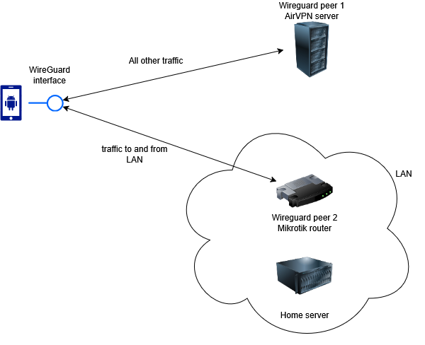

I’ve run into a wall trying to set up my Mikrotik router so that it acts as a Wireguard server that routes traffic to my LAN.
What I want to achieve:
  • I have an android phone with Wireguard, I want to be connected to a WG tunnel at all times
  • One peer of this tunnel is an AirVPN server, through which I want to route all public traffic
  • Second peer is my Mikrotik router, through which I want to route traffic into my LAN
    I want this connection to be active whether I am accessing from outside, or from my LAN (that is, some hairpin NAT will be also required)
I have successfully set up the Wireguard so that I can initiate the tunnel (the handshake occurs OK), however I cannot even ping the wireguard interface of the router from the client, let alone route traffic through it.
The wireguard interface has 192.168.3.1/24 address.

As to why I want this crazy setup: I am self-hosting stuff on my home server, and want to access some of it from my phone at optimal speeds, without exposing it to the internet.
Previously I used Tailscale, however now I want to use an actual VPN on my phone and sadly even GrapheneOS does not support running two VPNs at the same time on one user profile.
What configuration do I have wrong/am I missing in order to achieve the stated?
Thanks for any help

Draw a diagram because you seem to want opposed uses.
Is it not possible to route traffic through two separate peers on one wireguard tunnel?
That is what I’m trying to achieve here: to route traffic to my LAN over a peer (my router) connected through the public IP and to route all the other traffic through an AirVPN server
My router is reachable through a static public IP, though the address on the WAN interface is different. I already have working port-forwarding for web traffic for example (as can be seen from config)
