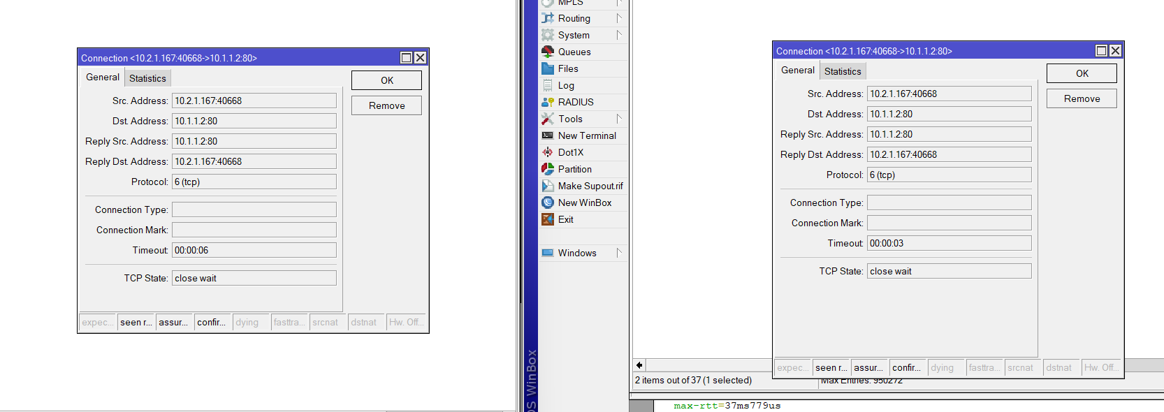

strange is from site1 i can ping all devices to site2 (even the opposite)
but on site1 when i open a browser and connect to a devices to site2 i can’t.
sometimes seems open a website but don’t work. load half pages…
strange is if i check on firewall connections seems is ok (i attach screen of both mikrotik)
someone can help me to point in right directions?
thank you in advance

for screenshot
left = site1
right = site2
i attach here export hide sensitive
