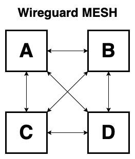

It would appear you have all four on same network, with all the same listening port in settings, all are listening on the same port in the input chain as well.
On the peer settings, each router has three peers.
I think I understand what you want to throw into the mix, you as admin via a remote laptop, for example, have connected to one of the routers and want the added ability to reach any subnet LAN or any other router for config purposes.
Not sure why you want to reach one through the other as you can simply DIRECTLY connect to the router you desire.
For example on wireguard app on my iphone, I would simply make four wireguard configs, one for each router… but its possible so why not think about it.
Now if one wants to wireguard and connect to ONE router and then reach the other three, I know how to do that in the ONE server scenario, but this is different and will have to think about it.
By the way this is apparently called FULL MESH or ( full mess ) TOPOLOGY.
As long as there is no requirement for any local subnet users to use the internet of a different router, this should work just fine. The admiin on the laptop coming into any router depending on firewall rules can access internet if desired…

Well, That is the purpose of a Mesh topology, a remote device need only connect to one router and should be able to access ALL Lans subnets, and all routers for config purposes.
If doing it with single server 3 client routers, one connects to the single server with the remote device and then you can reach ALL Lan subnets and all router for config purposes.
You are creating a monster LOL
@Usbuild - Once you’ve made some progress and set up your WireGuard tunnels, you can start considering a true “mesh solution” where all nodes connect with each other. This setup makes the network more redundant in case any link goes down.
To avoid adding static routes, try using OSPF. It keeps track of all links and automatically adds the necessary routes to each node’s routing table. A helpful tip: always set up a separate WireGuard link for management on each router.
If you’re thinking of adding more nodes to your network, you might want to consider an SD-WAN solution with built-in MESH support like ZeroTier or Tailscale. ZeroTier is already built into all ARM-based devices from Mikrotik.
I agree, It could quickly become a monster. That’s why I’m going to limit it by editing Allowed IPs and Forward chain to specific hosts.
I do believe there is an option to also limit Source Addresses in wireguard Input chain to known IPs, since all of them are dynamic it will break from time to time, but not often enough to become a nuisance. Actually, I don’t know if it will break tunnel when one the peers get new public IP, because both ends have persistent keep alive set, one of them should maintain a tunnel.
I like wireguard mesh topology a lot more vs OpenVPN server-clients setup I ones created… what a nightmare it was dealing with all routing tables, certificates, users and not to mention troubleshooting it all
Isn’t it already a Mesh?
If each of your 4 nodes is connected to all the others (ie 6 tunnels in your config), then the answer is yes. But if the other nodes only connect to a central node, the answer is no.
yes, they all have peers to each other
I looked into OSPF and it seems like an overkill for this size network. static routes should be easier to manage and troubleshoot. But ill keep it in mind as an option, thanks for the tip.
I wouldn’t call it overkill. OSPF is actually pretty easy to set up and used with the BFD option you get quick failover if a link goes down. You can always add OSPF later if you want, and you can run it on top of the static routes, which then act as backup routing.
I will definitely look into it, but at the moment I dont understand how it works and how it could possibly add failover to a mesh topology? i dont have any other vpn service or second ISP with enough bandwidth to handle alternative routes
@anav it all worked great until I added one more router to this mesh. I took a new rb5009 connected it directly to the modem with my laptop as the only host in subnet.
Router successfully joined wireguard mesh and I can connect to any mikrotik APs or CRS switches via winbox on any of the sites, except Mikrotik gateways itself and the worst part is, problem is inconsistent.
I left winbox on auto reconnect to site A, opened another session, connected to AP on site A via ROMON, discovered a router I’m trying to connect in order to see if any firewall rules are blocking connection and while doing it I noticed that winbox managed to establish connection after many retries. So nothing really changed, winbox finally reconnected after many attempts.
So winbox will eventually connect if I let it on retry. It doesn’t matter if I connect via private IP address or via FQDN.
What could be delaying connection?
Glad to hear it works no problem for 4 routers, perhaps 5 is a dark magic evil number. Did you name the new router LARSA by any chance? ;-PPP
To add a fifth router means
ON ALL FOUR ROUTERS you need to ADD another peer client
add allowed-peers=IPaddress#5/32,(anysubnets on said router 5), interface=wireguard public-key=“======” comment=“To LARSA:”
