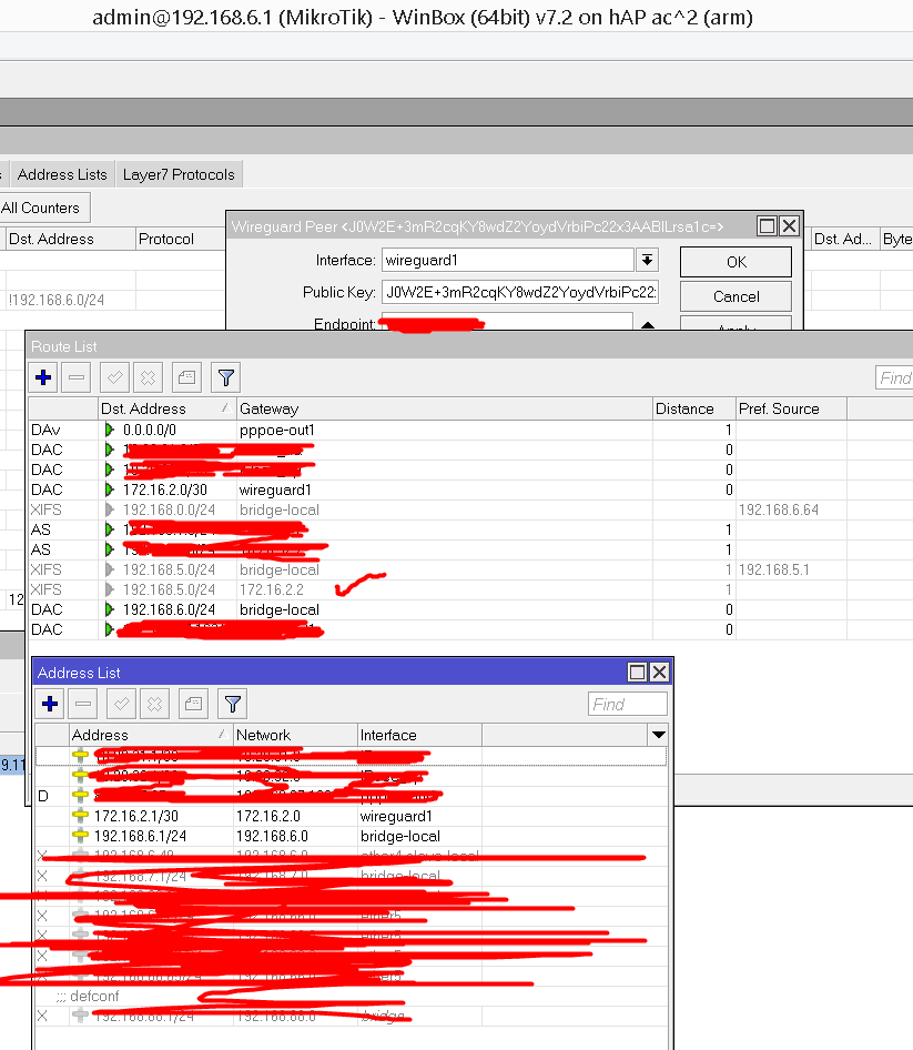

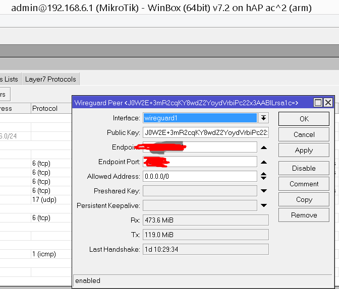

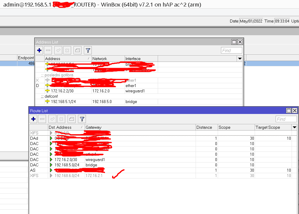

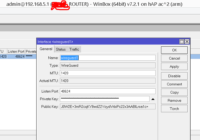

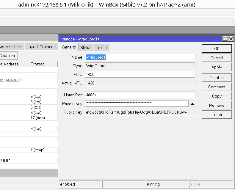

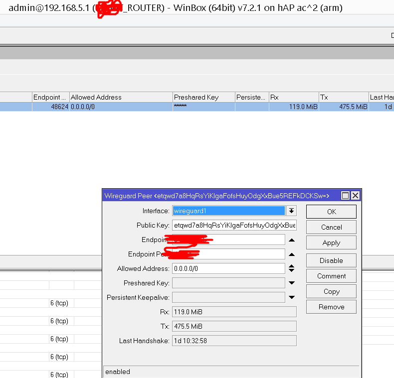

I have grayed out wireguard routes for know until i figure out why its not working, will use IPSEC
A pity you spend time on these screenshots…

I see nothing that can be usefull on those screenshots, only angry red marker painting.

xD i like red colors xD
