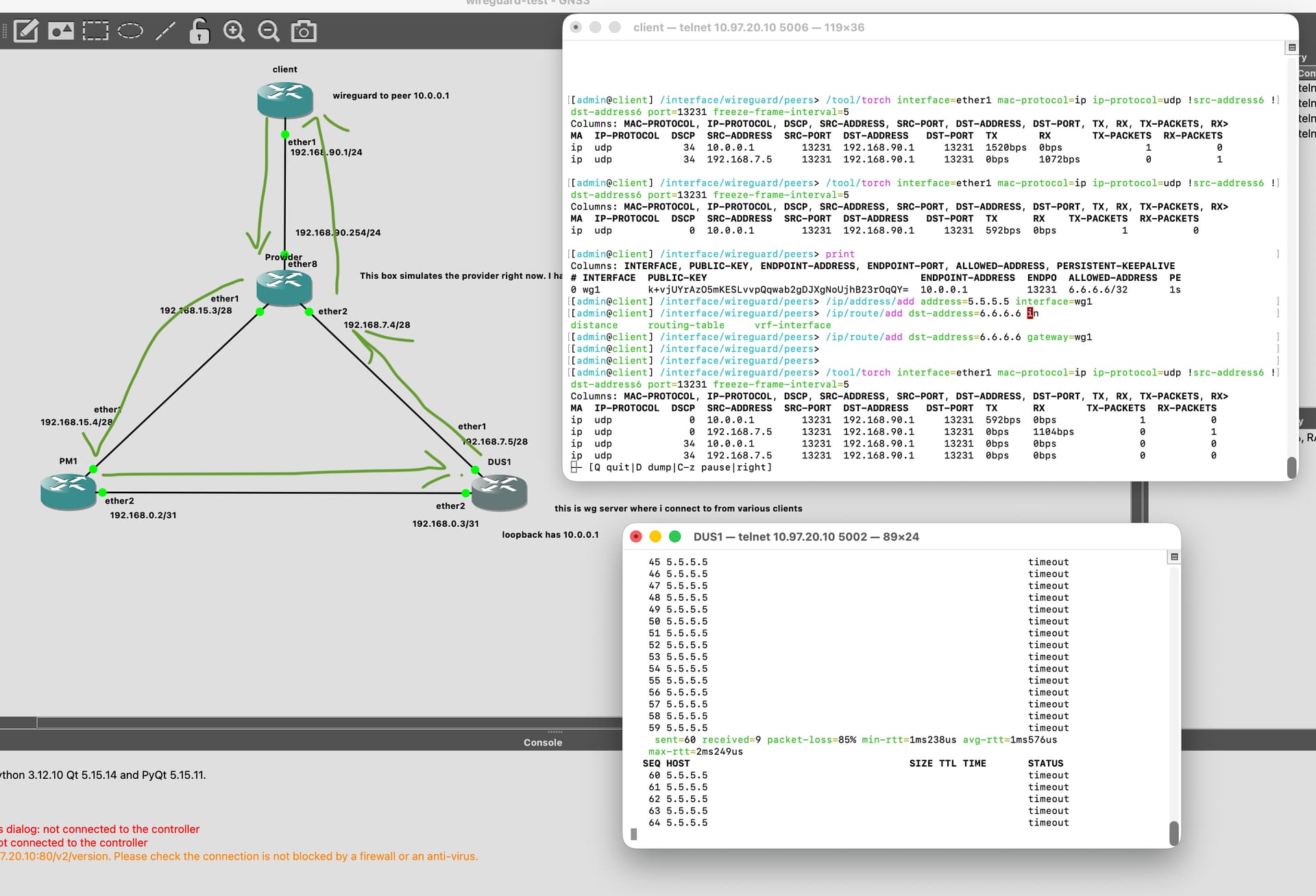

i have a wired problem with source adress selection of wireguard.
Basicly i have asymetric routing where the connection comes in via one interface and has to leave from another.
Now the router when that happens always chosses as source ip the ip on that interface instead of using the address that the connection came for. This only happens when the outgoing answer goes via a different interface then it came in. If it’s the same Interface incoming and outgoing i can’t observe that behaviour, then it always picks the source address that the incoming package had as destination even when it’s different from the ip adress of the interface.
It’s not a nat rule. ICMP and winbox doesn’t bahave like that even though it’s also traffic originating from the router so in my mind it should behave exectly the same. Only difference winbox is tcp instead of udp.
Coincidentally:
Maybe you can find in that thread and in the linked to post:
RouterOS blatantly ignores pref-src. Can this really be a bug? - #72 by lurker888
something useful to solve your problem.
Yeah it is a bit vague, I thought somone already had the issue.

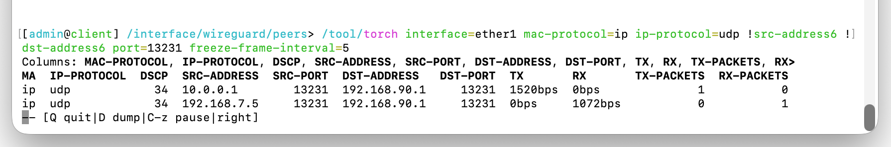

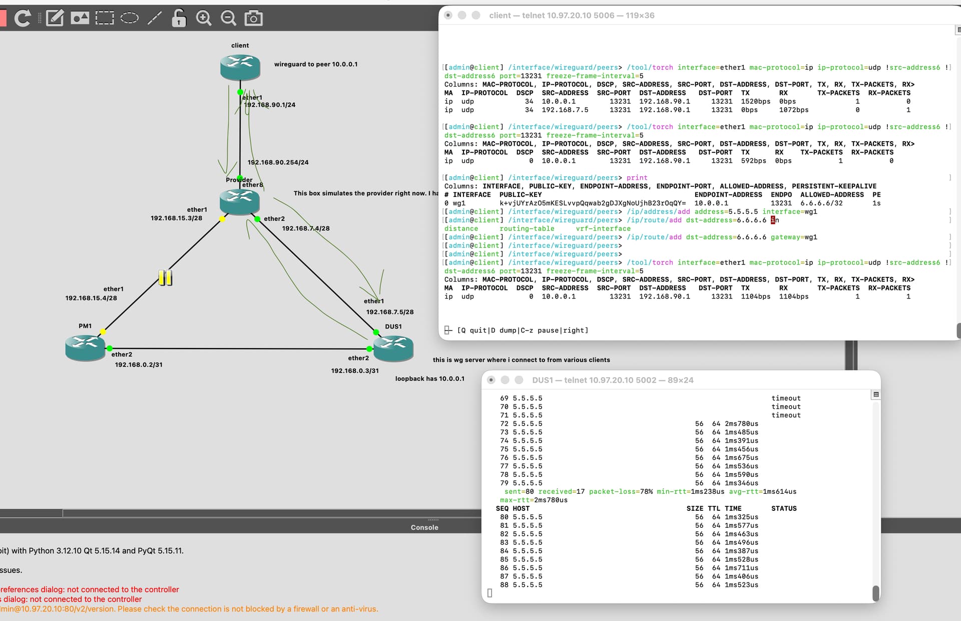

I made a complete testing setup in gns3 to reproduce the issue which is close to mine with the difference of no bgp only static, no igp and different adresses.
I use a CCR as client in that exemple and one as provider.
I only added the firewall rule established and otherwise drop on the client to basicly showcase how it would be from any client behind nat like i have it. In reality there is only public ips both as loopback and on the crossconnects. As long as the connection is symetrical it works no matter if via crossconnect or via provider but as soon as in-inter
face != out-interface it will select the source adress of the outgoing interface as you can see in the open torch tool. That breaks the connection for every client that is behind nat. The Arrows show the traffic flow to and from the server in the different scenarios.
Don’t be confused by src and dst ip in torch out of some reasen those have always been in wrong order on mikrotik. Look at TX and RX in torch to see if it’s incoming or outgoing.
Client
[admin@client] > export
# 2026-01-02 18:15:04 by RouterOS 7.20.6
# system id = CHX26FcEgXC
set [ find default-name=ether1 ] disable-running-check=no
set [ find default-name=ether2 ] disable-running-check=no
set [ find default-name=ether3 ] disable-running-check=no
set [ find default-name=ether4 ] disable-running-check=no
set [ find default-name=ether5 ] disable-running-check=no
set [ find default-name=ether6 ] disable-running-check=no
set [ find default-name=ether7 ] disable-running-check=no
set [ find default-name=ether8 ] disable-running-check=no
/interface wireguard
add listen-port=13231 mtu=1420 name=wg1
/port
set 0 name=serial0
/interface wireguard peers
add allowed-address=6.6.6.6/32 endpoint-address=10.0.0.1 endpoint-port=13231 interface=wg1 name=peer1 \
persistent-keepalive=1s public-key="k+vjUYrAzO5mKESLvvpQqwab2gDJXgNoUjhB23rOqQY="
add address=192.168.90.1/24 interface=ether1 network=192.168.90.0
add address=5.5.5.5 interface=wg1 network=5.5.5.5
/ip dhcp-client
add interface=ether1
add chain=input protocol=icmp
add chain=input connection-state=established,related
add action=drop chain=input
add gateway=192.168.90.254
add dst-address=6.6.6.6 gateway=wg1
/system identity
set name=client
Provider:
[admin@Provider] > export
# 2026-01-02 18:15:31 by RouterOS 7.20.6
# system id = qzyYuNFioDD
/port
set 0 name=serial0
add address=192.168.90.254/24 interface=ether8 network=192.168.90.0
add address=192.168.7.4/28 interface=ether2 network=192.168.7.0
add address=192.168.15.3/28 interface=ether1 network=192.168.15.0
/ip dhcp-client
add distance=1 dst-address=10.0.0.0/24 gateway=192.168.15.4
add distance=10 dst-address=10.0.0.0/24 gateway=192.168.7.5
/system identity
set name=Provider
PM1
[admin@PM1] > export
# 2026-01-02 18:15:50 by RouterOS 7.20.6
# system id = IF6ioZg1GqK
/port
set 0 name=serial0
add address=192.168.0.2/31 interface=ether2 network=192.168.0.2
add address=192.168.15.4/28 interface=ether1 network=192.168.15.0
/ip dhcp-client
add dst-address=10.0.0.1 gateway=192.168.0.3
add gateway=192.168.15.3
/system identity
set name=PM1
Dus1
[admin@DUS1] > export
# 2026-01-02 18:16:10 by RouterOS 7.20.6
# system id = +OdonftSVlP
/port
set 0 name=serial0
add allowed-address=5.5.5.5/32 interface=wg1 name=peer1 public-key=\
"nYZC2ostUH0bGjCiE2UdluzLRqq6SONTRD1jQGDTbQg=" responder=yes
add address=192.168.7.5/28 interface=ether1 network=192.168.7.0
add address=192.168.0.3/31 interface=ether2 network=192.168.0.2
add address=10.0.0.1 interface=lo network=10.0.0.1
add address=6.6.6.6 interface=wg1 network=6.6.6.6
/ip dhcp-client
add gateway=192.168.7.4
add distance=10 gateway=192.168.0.2
add dst-address=5.5.5.5 gateway=wg1
/system identity
set name=DUS1

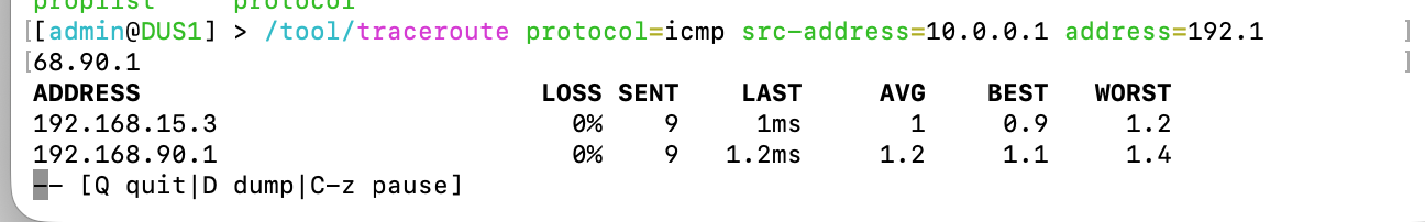

Yes, as you can read from the link @jaclaz posted above to @lurker888's post: What you see is not a new finding and has been explained by @lurker888. He also posted the workaround in the linked thread.
I read that already but as far as i understood that is a bit of a different case there. The wan connections are with masquarade rules changing the sorce ip. I can’t do any of that since i have connection tracking disabled and run completly stateless on that router with only some very simple firewall rules since it’s one of the edge routers for me. I don’t understand that behaviour because tcp connections like ssh and winbox work as expected and always use the src address also for replies. Is there any other solution to this? Why does it behave that way. Also i noticed pref. source gets ignored, i haven’t set any but i also don’t want to use pref source anyways because that would lead to some other undesired behaiviour in other cases.
Selection of the pref src for the source address is correct (i.e. the intended) behavior for wireguard. It is specifically designed this way as a logical consequence of roaming being a feature and the symmetrical roles of the parties (foregoing the usual server-client arrangement.)
The thread that was suggested to you contains full play-by-play explanations on how this comes about. Also linked is my (slightly verbose) treatise on source address selection in general, the gist of which is that for tcp, the source address must be (and is) set to the dst address of the initiating packet; this also holds true for common udp-based protocols like dns and openvpn. That is why you don't experience this elsewhere.
This is hardly the first time someone has encountered what you have on your hands, and you are correct that in case you have disabled connection tracking, that advice is not for you.
The correct path for you is, believe it or not, through correct assignment of pref srcs. The correct way of doing that is by using the relatively new feature (at least in RouterOS) of having the ability to assign a vrf to the wg tunnel, and having your preferred address for the wg endpoint set up there.
The other, far less satisfying, solution is to use different devices for the wireguard server role. While this sounds a bit strange, generally having forwarding and management or service type devices separate has benefits in terms of stability. Of course I don't really know what the rationale behind your setup is and this last remark could be way off base.
By design, Wireguard itself does not use symmetric UDP flows. It treats each packet it sends individually in terms that it always finds the best route and thus also source address for it, ignoring any transport (UDP) level context. The reason for this is to make it possible to accommodate to address changes on both its own and peer side. The complementary behavior in the receiving direction consists in accepting an incoming packet based on its “session ID” (I don’t know the official term) alone, i. e. regardless its source socket and destination address.
This would work well in the ideal internet “where every neighbor is a friend” without any NAT and/or firewalls. But as soon as the remote peer is behind just a firewall, not even NAT, which only lets through incoming packets that are UDP-level responses to previously seen outgoing ones, a change of address and/or port on the local peer means that packets from this new socket will not make it to the remote peer through that firewall.
Since there is no checkbox to tell the Wireguard implementation on Mikrotik to stick with the local socket at which it has received the initial handshake packet from the peer, @lurker888’s workaround is the only way how to facilitate communication between a Wireguard instance on Mikrotik and some peer in the internet that is behind any kind of traffic filtering device.
Given that you know that it is possible to disable connection tracking completely, no doubt you also know you can keep it enabled but use action=notrack rules in /ip/firewall/raw to prevent only chosen traffic from being actually connection tracked. The question I cannot answer is the impact of adding the following rules on the CPU load/throughput of your edge router:

Thanks for all the replies.
Like already guessed it’s just an admin connection from outside and it’s only there for 2 cases.
If my Proxmox cluster is down or if my own IP network doesn’t work because of issues with bgp on the two routers.
If everything works I have several other ways to get access via other vpns with chr routers that i use all the time.
Basicly the Idea is to have those wireguards one on each router and be able to connect via any IP of that router.
At some point that is not needed anyways because i will design a dedicated oob network with it’s own uplink.
My provider uplinks have a /28 subnet, but i only use one ip address basicly only to run bgp sessions. Is there any way to have a virtual ethernet interface as subinterface of that uplink interface which i could put in a vrf with the wireguard and it’s own ip address? Kinda like a vlan just without tagging traffic.
Also if i put the wg interface in a vrf it will use that one also for the tunnel traffic, not just the traffic through the tunnel?
Would be best if i can assign one vrf for wg traffic and another for the traffic that goes through the tunnel, but that can be solved with route leaking or routing mark in mangle.

But mind you, the possibility to choose a particular VRF for the transport&handshake traffic of a Wireguard instance is only available in 7.21.x which is a testing version as of now.
Ah ok, so I just tested it in 7.21. Now there is the option to just set a vrf for the wireguard interface/instance. That fixes the issue for me.
That i didn’t get before, i thought you ment just binding the wg0 to a vrf via /ip/vrf interfaces=wg0,wther1 would also affect the transport&handshake traffic which didn’t make sense to me.
Until then i can live with the current behaviour.
Macvlan interface of course that will work, even remembered that option as soon as i read it, was searching for some virtual type but macvlan is exectly what i need.
That way i have another interface and route for wireguard.
Better then using main table because there i run severall full tables.
This is really a place full of knowladge and people that like to help, thanks!
