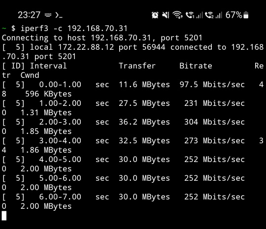

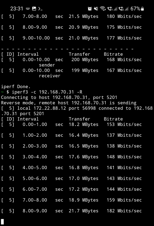

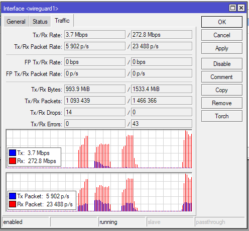

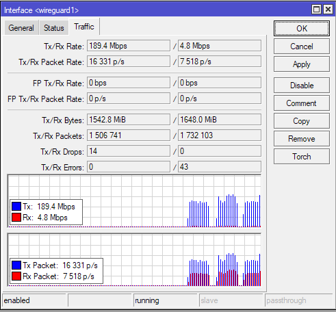

LE: v7.4beta4, RB5009, Samsung A52s 5G, test over wireless, 390Mbps link (the phone is only 1x1 sadly):
