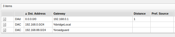

I think the routing between the WG interface and my local network isn’t configured properly.
Routes:

In order for your WireGuard network to access the Internet you will need to configure NAT(srcnat chain) for the WireGuard network on the gateway router.
For WireGuard to access the lan try adding it to the LAN interface list:
add interface=wireguard list=LAN
Your peer is also not correct, it should be 192.168.88.2/32
I suggest you read the documentation - https://help.mikrotik.com/docs/display/ROS/WireGuard
Also → https://forum.mikrotik.com/viewtopic.php?t=182340
