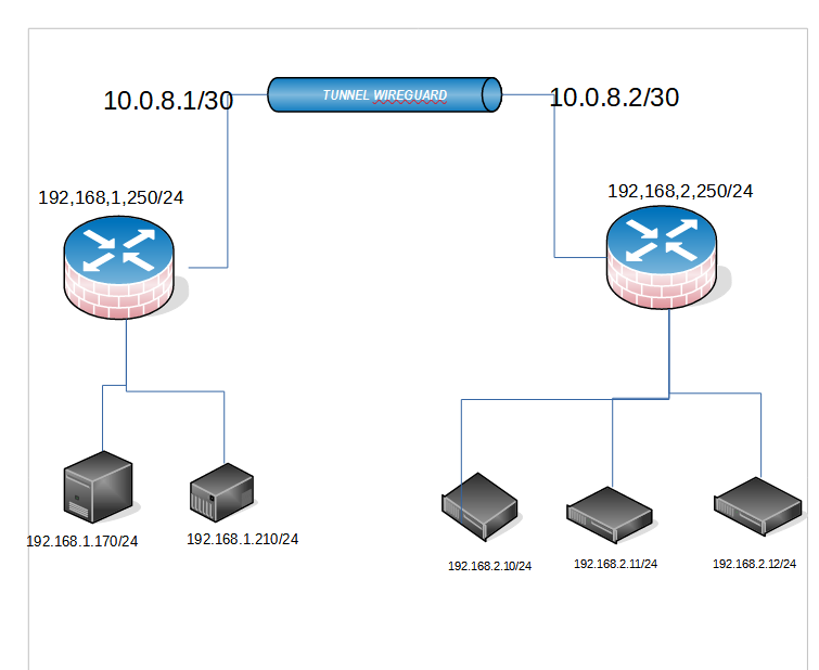

Hi guys, I have a tunnel made with wiregard, everything works, only I can’t create a NAT on a specific IP, I would like the router’s IP to when they connect to the router B the router B all on a specific IP on the net
Do you have a suggestion to give me?
Thank you
Yes provide a decent network diagram, to show what are the two or maybe more clients connecting to the server…
If any MT devices are involved, provide the config.
/export file=anynameyouwish ( minus router serial # and any public WANIP information keys etc…)

Need context, no network diagram.
Is this device connecting as a client to another device and what is the other device or is this devices a server for initial connections from a client router and what is this other router??
( I also see another remote connection as well )
Dont have any clue what you are trying to accomplish with sourcenat rules for single IPs and then the entire local subnet out the wireguard tunnel.
As I said, where are they going ??? The traffic flows are too vague to work on.
I created a site to site tunnel and it works, only that I would like everyone who wants to connect the router B on router B addresses them only on an internal IP.
your explanation is not clear.
Network diagrams and Requirements, use google translate as your english is not working out very well.
https://forum.mikrotik.com/viewtopic.php?p=908118
Sorry for my English,
So as seen from the scheme, I want addresses 192.168.2.10/11/12 to see only the computer 192.168.1.170, the rest of the Network 192.168.1.0/24 must not access.
Okay so you have two routers, both MT if so you need to post both not just one.
Also do you want users on both routers to initiate a tunnel ( put another way both routers can be both client and server for initial connection )
Assuming both have publicly accessible public IPs…
I did not put the public IPs since the connection works.
The current configuration is site to site, and are on 2 mikrotik rb750gr3.
The two networks 192.168.1.0/24 and 192.168.2.0/24 both parts work, only that the computers that they provoke from 192.168.2.10-12/24
They only have to see the server 192.168.1.170/24.
I tried to create a NAT but it does not work, while before with the OpenVPN it worked, I think it is due to the fact that Wireguard works on another OSI level.
