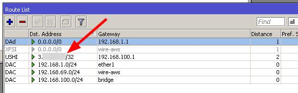

Could you guys take a look at the attached screenshot and guide me a bit, there is something I am doing wrong of course, but I feel like I am almost there. Thank you so much

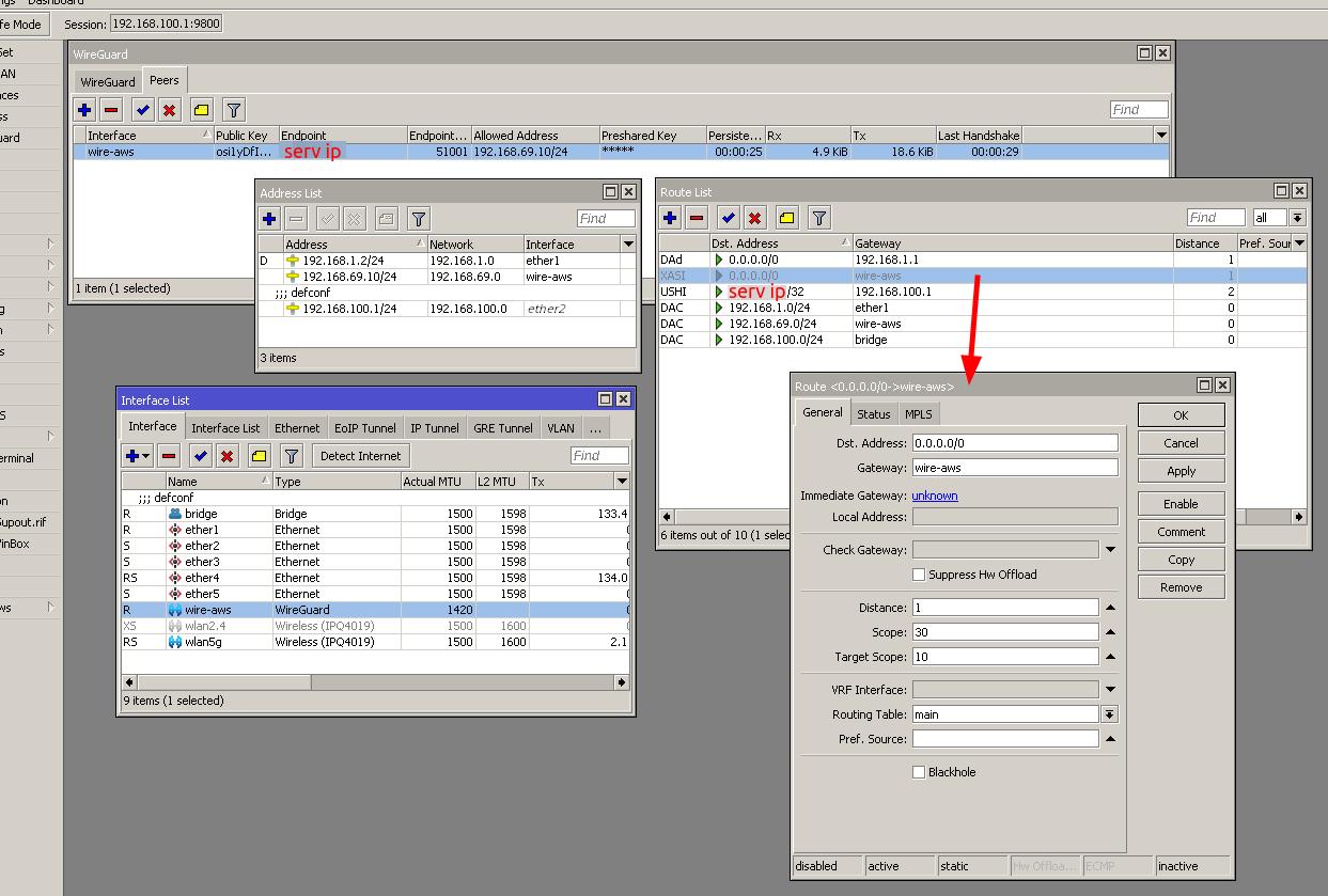

As i mentioned in my first post, the wireguard tunnel is setup and working.
I am able to see traffic back and forth in the Mikrotik’s wireguard panel when I activate the connection, I am also able to ping the server’s wireguard interface (192.168.69.1) from the Mikrotik’s terminal and ping the mikrotik tunnel (192.168.69.10) from the ubuntu server.
The Mikrotik is behind the ISP gateway 192.168.1.1 but I am not sure that matters, i can connect all my linux clients independently (connected to the Mikrotik) to the Ubuntu wireguard server and there is nothing configured in the ISP gateway.
I am just missing the part to route all the local LAN clients on the Mikrotik to the already established wireguard tunnel.

The route is already there (pointed in the screenshot below), but when the wireguard connection is active, the clients connected to the Mikrotik in the LAN still go around it using the local IP from the ISP. Then the grayed out 0.0.0.0/0 wire-aws, if enabled, that is when i lose connection to the internet.
Maybe i am typing the wrong gateway 192.168.100.1 ? That is the local IP for the Mikrotik router, should i use something else?

As holvoe noted,
lets say take ether5 off the bridge.
give it an Ip address
add address=192.168.55.1/24 interface=ether5 network=192.168.55.0
Ensure ether5 is part of LAN LIST on interface members.
Then to complete the config do it by connecting your PC to ether5 and give the pc an IPV4 address static of lets say 192.168.55.5
Should be good to go.
