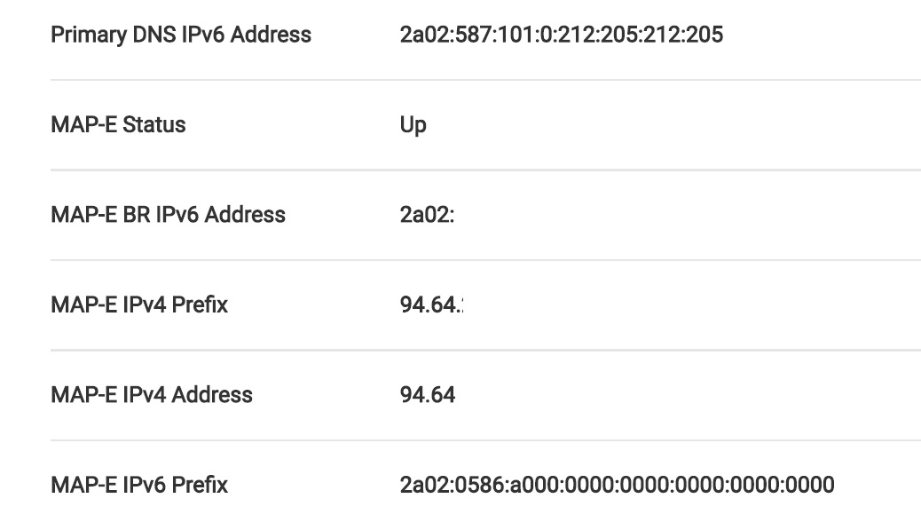

On the WAN Status of my ISP Router i have MAP-E IPv4 Address which i dont know exactly whether is the cause of the problem. I am not behind CG-NAT (i have asked my ISP to do that) as i can see the same public IP on the internet as shown in my ISP router web interface. Can anyone help me? Am i missing something?
