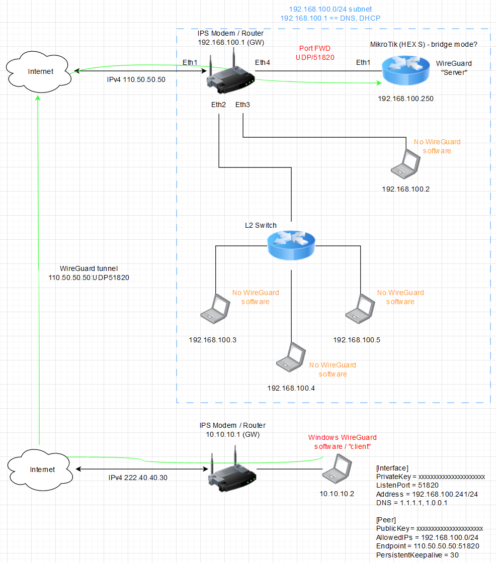

I need assistance with a MT wireguard setup in non-MT network with basic ISP modem / router (means, very little configuration possible on the ISP modem / router side).
I would like to add a MT router inside of a small local network and make it reachable from outside. “Outside” being a group of laptops with WireGuard software installed.
So in short, VPN access for remote workers. I’ve attached the diagram below.
To be fully honest, I don’t know how to make laptops (192.168.100.2,3,4,5) reachable here. How would the configuration on the MT need to look like, in order for this work?
MT has to be in the same subnet (192.168.100.0/24), and the ISP router / modem is the gateway / DHCP / DNS server.
I guess in this scenario the ISP DHCP would need to be restricted to hand out IPs in following range: 192.168.100.1-192.168.100.240 (so that the wireguard VPN client range doesn’t get used by accident). 192.168.100.240-192.168.100.250 stays reserved for the remote workers.
I’ve made few tests and gotten the tunnel connection established (so I can confirm that port forwarding to the MT works), but couldn’t reach devices on any end.
Thank you in advance for your time!

Pretty much whole ISP / destination subnet (192.168.100.0/24) should be reachable via the tunnel. “10.10.10.2” is a “remote worker” who needs to access internal resources, such as 192.168.100.2,3.4.5.
Unfortunately the ISP modem cannot be in bridge mode. I know that having everything go thought MT would make things way easier (and I would manage to set it up myself in that scenario).
Is the above described setup even doable? (network diagram pic)

Your situation is very common and there is nothing complex about it.
You want to setup the hex behind another router so as to be able to reach an internal network.
The one caveat is that you need to be able to port forward the mikrotik listening port from the ISP router to the HEX router ???
Assuming thats possible.
One can setup the hex as a bare bones routing device.
The one thing to be sure of is to have a source-nat rule to the WANport on the hex, so that all wireguard requests to the subnet look like they are coming from the WANIP of the hex ( also its LANIP on the subnet of the ISP modem/router ). Otherwise although the ISP modem router would have no way of directing any return traffic back to wireguard source addresses as they are not local to the ISP modem/router and would get dropped.

Regarding Clients… This is really messed up!!
(1) The address of the wireguard client is the address on the WG network thus it should be
110.50.50.2/32
If you had another client you could give it.
110.50.50.3/32
(2) The allowed IPs is missing the wireguard Ips…
You can choose
allowed-ips= 110.50.50.0/24,192.168.100.0/24 ( which allows you to ping any other wg device (useful if other client routers in the mix) and of course the subnet in question
OR
allowed-ips= 0.0.0.0/0 which includes all of the above and in case you wanted remote users to use internet of ISP router.
(3) The endpoint shown in your illustration is not correct. The endpoint is the PUBLIC IP of the ISP router.
How do you propose to provide that?
Is the WANIP of the ISP modem router a fixed/static or dynamic WANIP.
One option is to use the IP CLOUD function on the hex router for the dynamic case if you dont already have an existing dyndns name/provider.

About the bottom right corner of the image (wireguard CLIENT side config). Allowed IPs are IPs / ranges which will be routed into the tunnel.. so why would I add “110.50.50.0/24” there?
Also, on the client side, the “endpoint” is the destination for this wireguard tunnel, which is and should be (in my case) 110.50.50.50 (public IP of the destination ISP modem / router).

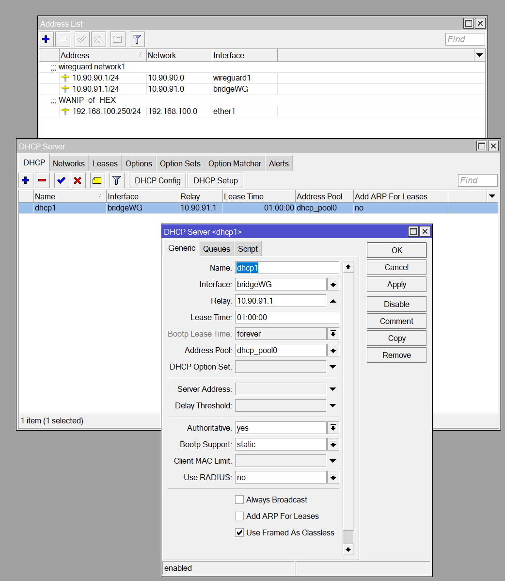

What I noticed is that communication back isn’t working (from within the main ISP network) to the “remote worker”. But I guess that’s because the ISP router doesn’t have a route for 10.90.90.0/24?
Also, on the MT ether2,3,4,5 LAN has no working DHCP, any idea why?
Of course there is a route back through wireguard… its created by the Ip address for wireguard.
check the ip tables on the hex
dst-address=10.90.90.0/24 gateway=wireguard1 routing-table=main
You also changed the setting for IP DNS,
recommend for now changing it back… to 192.168.100.1
The one big boo boo you made was changing the name of ether1 but not reflecting that everywhere…
Mainly the interface list settings… interface=ether1 list=WAN
Get rid of this relay addition, no idea where it came from.
add address-pool=dhcp_pool0 interface=bridgeWG lease-time=1h name=dhcp1 relay=10.90.91.1[/color]
add name=bridgeWG
set [ find default-name=ether1 ] comment=Uplink
/interface wireguard
add listen-port=51820 mtu=1420 name=wireguard1
add name=WAN
add name=LAN
/ip hotspot profile
add name=dhcp_pool0 ranges=10.90.91.2-10.90.91.254
/port
set 0 name=serial0
add bridge=bridgeWG interface=ether3
add bridge=bridgeWG interface=ether4
add bridge=bridgeWG interface=ether5
add bridge=bridgeWG interface=ether2
add interface=bridgeWG list=LAN
add interface=wireguard1 list=LAN
add interface=Uplink list=WAN
/interface wireguard peers
add allowed-address=10.90.90.10/32 interface=wireguard1 public-key=
“xxxxxxxxxxxxxxxxxxxxxxxxxxxxxxxxxxxxxxxxxxxx”
add allowed-address=10.90.90.11/32 interface=wireguard1 public-key=
add allowed-address=10.90.90.12/32 interface=wireguard1 public-key=
add address=192.168.100.250/24 comment=WANIP_of_HEX interface=ether1 network=192.168.100.0
add address=10.90.90.1/24 comment=“wireguard network1” interface=wireguard1 network=10.90.90.0
add address=10.90.91.1/24 interface=bridgeWG network=10.90.91.0
/ip cloud
set ddns-enabled=yes
add address=10.90.91.0/24 dns-server=10.90.91.1 gateway=10.90.91.1
set allow-remote-requests=yes servers=192.168.100.1
add dst-address=0.0.0.0/0 gateway=192.168.100.1 routing-table=main
/system clock
/tool mac-server
/tool mac-server mac-winbox
  1. Ensure port forwarded 51820 on ISP router to 192.168.100.250 protocol=udp
  2. Since there are no firewall rules on the hex, the router should receive the handshake.
    (without a firewall rule, we cannot establish if the rule has been executed so thats a reason to perhaps stick in some firewall rules for troubleshooting purposes)
  3. Assuming the connection is made since there are no firewall rules, the remote wireguard warrrior should be able to reach, both the router for config purposes or the users in the 192.168.100.0 subnet.
Since the MT device has an IP route to the gateway of 192.168.100.1, all traffic leaving through the gateway will get sourcenatted with the IP of 192.168.100.250.
The traffic will either go out the internet or to another device on the local LAN as the ISP router knows about this subnet and where to route traffic.
Return traffic will be sent to 192.168,100.250 and will go back into the mT router. The MT Router will unsourcenat the traffic back to the wirguard remote address and due to existing router will send return traffic back to the tunnel and the router will match with the correct peer.
Thus I dont see any impediments to it working.
  • The DNS was changed due to testing related to the dyndns.
  • About the interface name change “ether1”, I think you must’ve missed something (the “Uplink” thing you saw was just a comment), because the name change was done via WinBox and it is reflected everywhere.
  • About the DHCP relay thing, thanks, not sure how it slipped in. Now DHCP works (on the MT ether2,3,4,5).
    When I posted my last comment, everything worked expect for the DHCP on MT LAN. Port forwarding was already configured on the ISP router and working.
