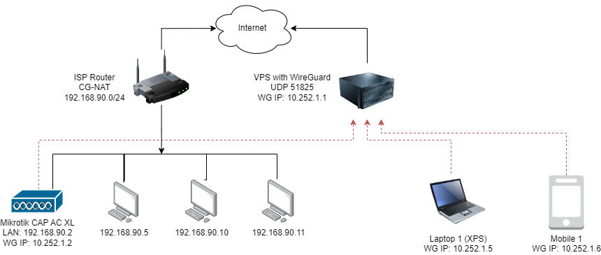

I’m struggling configuring an MT router to allow access to local network through wireguard. At the moment I’ve setup an VPS with wireguard server and router connects to it sucessfully.
The ISP router is an LTE router with CGNAT, not possible to open ports or making routes. I’m attaching a diagram to make it clear.
The goal is to make Laptop1 reach ISP Router’s LAN subnet devices (192.168.90.5,192.168.90.10, etc.). I’ve tried to follow @anav posts here on the forum (really helpful) but I feel that there’s something I miss or not doing correctly.

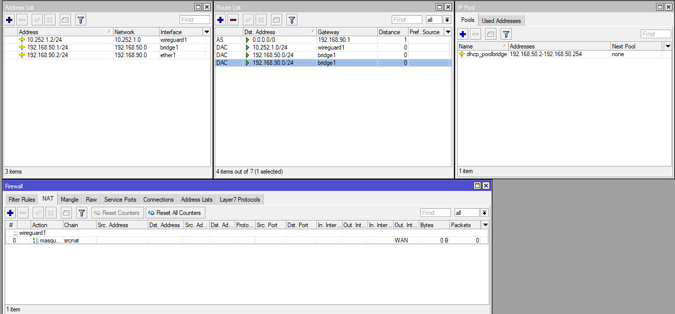

  • Point #4
Sorry for that, appears that the command used
export
didn’t export routes content, maybe exists another command, pasting an screenshot here:
No firewall rules, and NAT rule corrected
At the moment I can ping CAP ip 10.252.1.2 from laptop wireguard client 10.252.1.5, still trying to ping 192.168.90.x equipment from laptop but no joy… will try some changes.
Again thank you in advance for your help
Well thats a completely different kettle of fish.
Because you had a WAN interface list, I assumed you wanted the capac to act as a router not an AP/switch.
Also I dont use capsman, why bother if you only have the one device, aka not required???
What I have to think about is whether or not a capac in the ap/switch setup can be an effective wireguard client.
We can experiment LOL.
Hello anav,
Regarding the interfaces list I’ve started from Mikrotiks default configuration, the only thing that I’ve done is to change to CAP via quickset with Static Ip address.
The reason to use CAP AC XL for this wireguard thing, is because is a device that I have more or less at hand at a remote location with CGNAT. (In reality I can access the remote network and lan devices via Zerotier installed on remote lan computer).
Basically I’ve tried this same device with the new back to home feature and it’s working good (to access lan side of CAP AC XL), basically I want to do the same but manually with my own VPS, the reason to do that is to add non ARM devices that I have on remote clients (I don’t need so much speed).
Best regards
