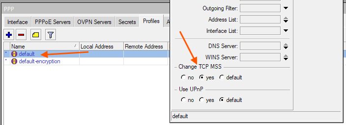

If your internet link use PPPoE for example, and RFC 4638 is not implemented, then normally the MTU is limited to 1492 bytes. In that case, such MSS adjustment is needed too. Because devices in LAN still think the MTU is 1500 and don't know that there is a bottleneck when the packets need to go out to the internet. But in RouterOS if you use the default PPP profile with your PPPoE client/server instances, then the router will does the MSS clamping to accommodate this reduced MTU automatically for you. This is the relevant setting on the default PPP profile:
But this only acts on IPv4. If you use PPPoE with MTU 1492 and IPv6 too, then you'll need to either announce this reduced MTU using IPv6 -> ND, or add the IPv6 mangle rules to clamp MSS to 1452.
Same thing should be done for other tunneling protocols that reduce the possible MTU.
