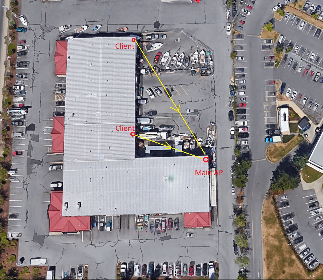

I have installed may of these AWESOME kits they all worked flawless, now I want to do a little but more.. If I have a wireless-wire kit, can I buy another ap and connect it to have 2 ap’s talk to the main ap ? ( of course copy information like shared secret password & ssid info.
OR Do i need to buy 3 60g ap’s and re configure all 3.

No, order one wAP 60G AP (this will be your Main AP in your attached pic.)
Order one Wireless Wire kits to reconfigure as your two clients. Or, in place of the Wireless Wire kit, you can order two wAP 60G. The wAP 60G is the same devices as is in the Wireless Wire kit, but just one. I include this for availability reasons.

The 3 pieces you suggested arrived today, took me 3 min to change the config and have them all talking ! Thank you for your help sir !! YOU ROCK !
