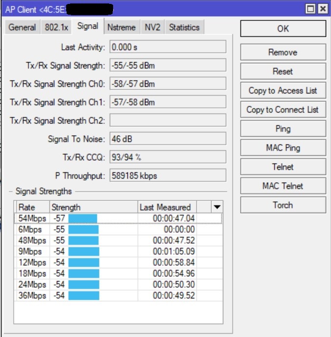

I would like to know where I can troubleshoot this issue. I cant comprehend why I have such as fast air rate, of 590000 kbps and only get a real 75 Mbit udp performance.
The link is 25 Km, NetMetal 5 on each end, 30 db antenna’s.
Perhaps it is my configuration of the wireless Bridge? the two end networks have thier own subnet, and the wireless hardware is on its own subnet. eg Lan 1 192.168.1.X, and the other is 192.168.17.x Wireless is 10.10.10.x
Ether 1 and WLAN are bridged on each NetMetal, and have IP assigned to the bridge. The ethernet is connected to another mikrotik device, which has an IP for the 10.10.10.x/24 on the ethernet interface that it connects to, the other ports of the Local Lan are bridged and have thier own IP on it eg, 192.168.1.1
Where am I going wrong? Or am I?
I have had this link up for a long time, but cannot pinpoint when it started to slow down. I used to be able to get 180 Mbit, and over 200Mbit at times.
Is my configuration messed up?
I am by no means schooled in networking, I know more than the basics, but im at a loss, why an 80 Mhz wide channel, 2 chain, with 90+ ccq in nstreme gets a real world throughput so significantly different than the P Throughput. At least from what I recall, this P Throughput was very closely attainable by the link
I have a funny feeling, data id being bounced back and forth or something that I I cannot see.
If I have to reconfigure the whole thing I will, I want to achieve the fastest possible speeds.
I just tested this link by switching to 802.11N with 40mhz channel. Connected air rate is ~ 220000 kbps, but still only able to get the 75Mbit over the link.
So if the 802.11AC with Nstreme on 80 MHz channel gets the same speed as 802.11N on 40mhz channel. Something has got to be wrong.
Any ideas where to look, or to chnage the configuration?

I have tested with file transfers from a PC to PC and also with each end router ( Mikrotik Bandwidth test. the CPU gets to about 50% with either way of testing.

No I know I am probably not going to get 590 mbit over the wireless, but would be nice. But 75 is a far cry from the air data rate.

Tried all of this, speeds did not improve. However, after the wireless reconnected, the traffic started to pass much quicker (In time ) than before. IE from time of wireless connect to data actually moving.
Im confused as to why this is like this. Such a good signal, but such a slow throughput.
