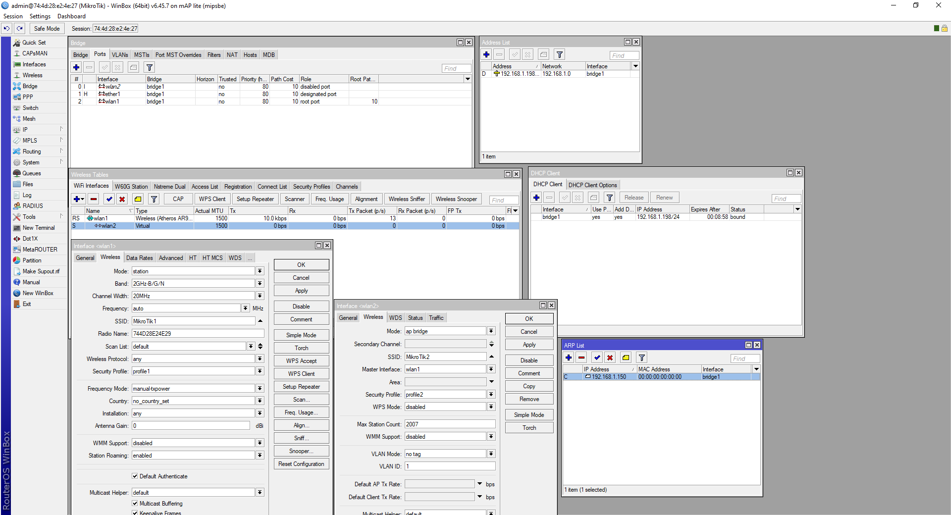

This is the configuration of the Map Lite. MikroTik2

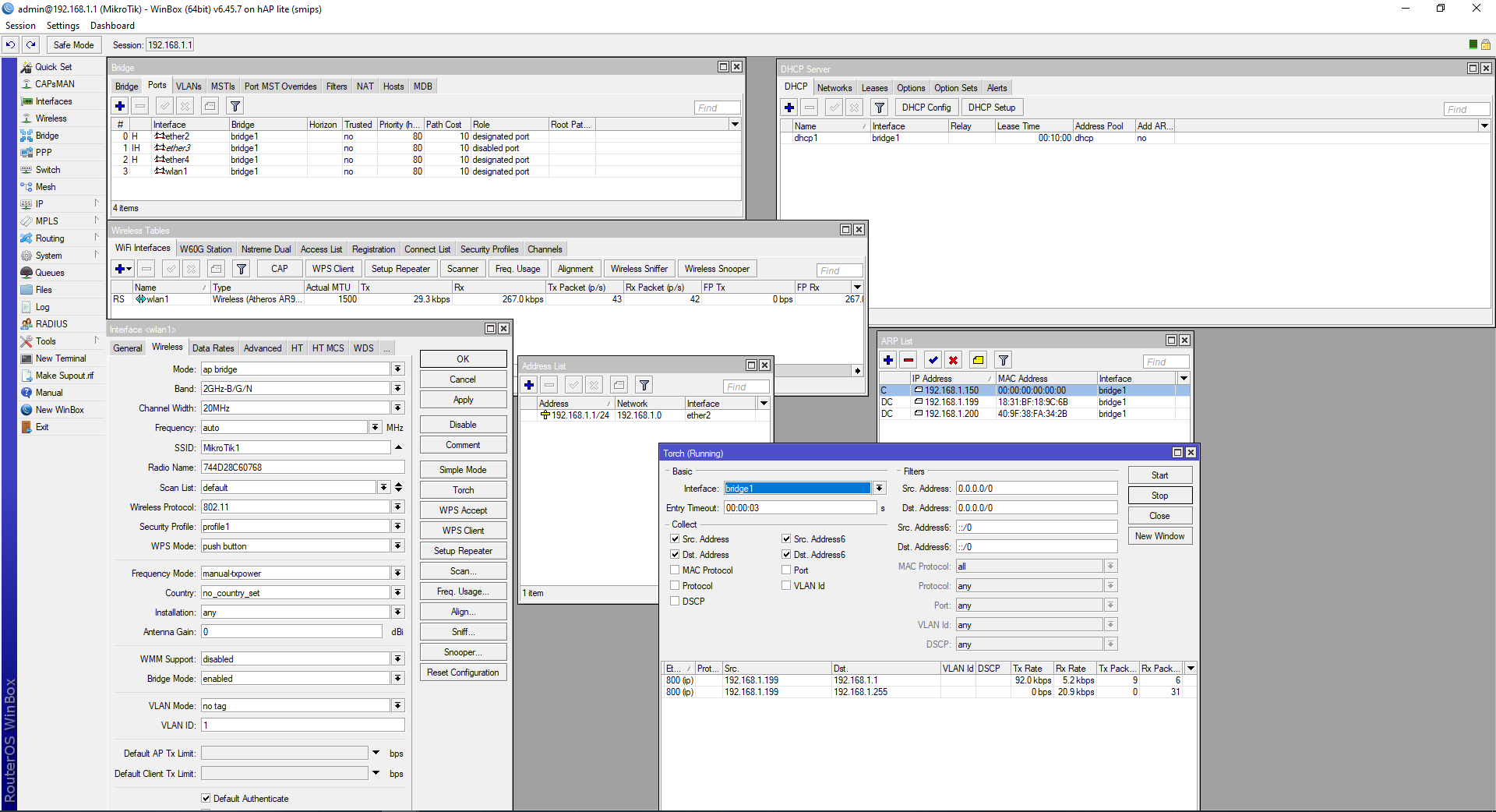

And this is the configuration of the Hap Lite. MikroTik1
I have a device with a static ip 192.168.1.150 connected via ethernet in the Hap Lite (MikroTik1). What I want to do is to be able to see that device through wifi when I am connected either via ethernet or wifi to the Map Lite(MikroTik2). What can I do to these configurations to be able to do that? Can it be done?
In the ARP list I added manualy the ip 192.168.1.150 because it did not appear.The device is plugged in ethernet port 2 on the Hap Lite. It is working properly because when i plug it in my laptop I can ping it in command promt.
I was able to do it. So no problem. I could ping the device with 192.168.1.150 when connected via ethernet or wifi to the map lite. You actually helped. Ευχαριστω.
