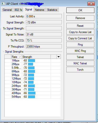

I’ve been struggling to improve my AP performance on my home RB532a. There isn’t much about AP mode on the MT…it all seems to be MT to MT.
I recently replaced my b/g card with a R52nM. I was hoping this would give me a some boost on my current MT until there was hopefully an affordable device with Gig interfaces. RB800 is a little too much $ for home use.
So…with my new card I was only getting about 6Mbps even when I had a good signal.
I futzed and futzed and today (just before writing this post) I happened to look at my laptop driver. I took a chance and disabled B (went from a/b/g)…leaving it G and N (the Windows 7 has N in a different section). See picture below.. This got me up to about 16Mbps. This isn’t too bad. I may be nearing the limits on my MT board. I often see CPU go into the 90%s. Normally I’m in the 5% range.
I don’t get why it was up to my client to determine the rate.
I understand I can dedicate another radio (if I had the slot) to lower rate clients (which I am willing to do if I upgrade HW)…but I couldn’t get the client to connect if I set the MT radio to 2 GHz only N. It was always unhappy about “does not support all basic rates”. I never could find info on what I needed to allow.
Before I take a leap and upgrade my hardware, I want to make sure I can milk ever last bit of what I got. Right now, I don’t actually think I’m getting an N connection, but instead a G connection.
Thanks for any thoughts and comments.
