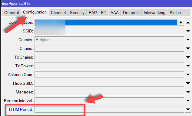

On many forums it is recommended to change the DTIM regarding the iPhone, but how? The iPhone 6 kept disconnecting and connecting, resolved on the iphone forums. . . . . but mikrotik has it in the ass.
The last plastic router also has this setting. . . .
This ?
I don’t have iPhones at home, so I don’t use it.
Be advised that’s on a wifiwave2 device, though.
