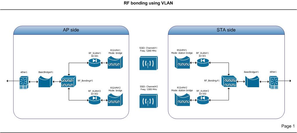

Wireless bonding technique.
I have repeatedly seen a question about wireless cards bonding. Usually offered tunneling scheme(like EoIP) works quite well but dramatically decreases performance.
In my practice I use aggregation of wireless interfaces through VLAN.
General principles set out below:

In result we have the aggregate wireless bridge with kept transparency and performance:

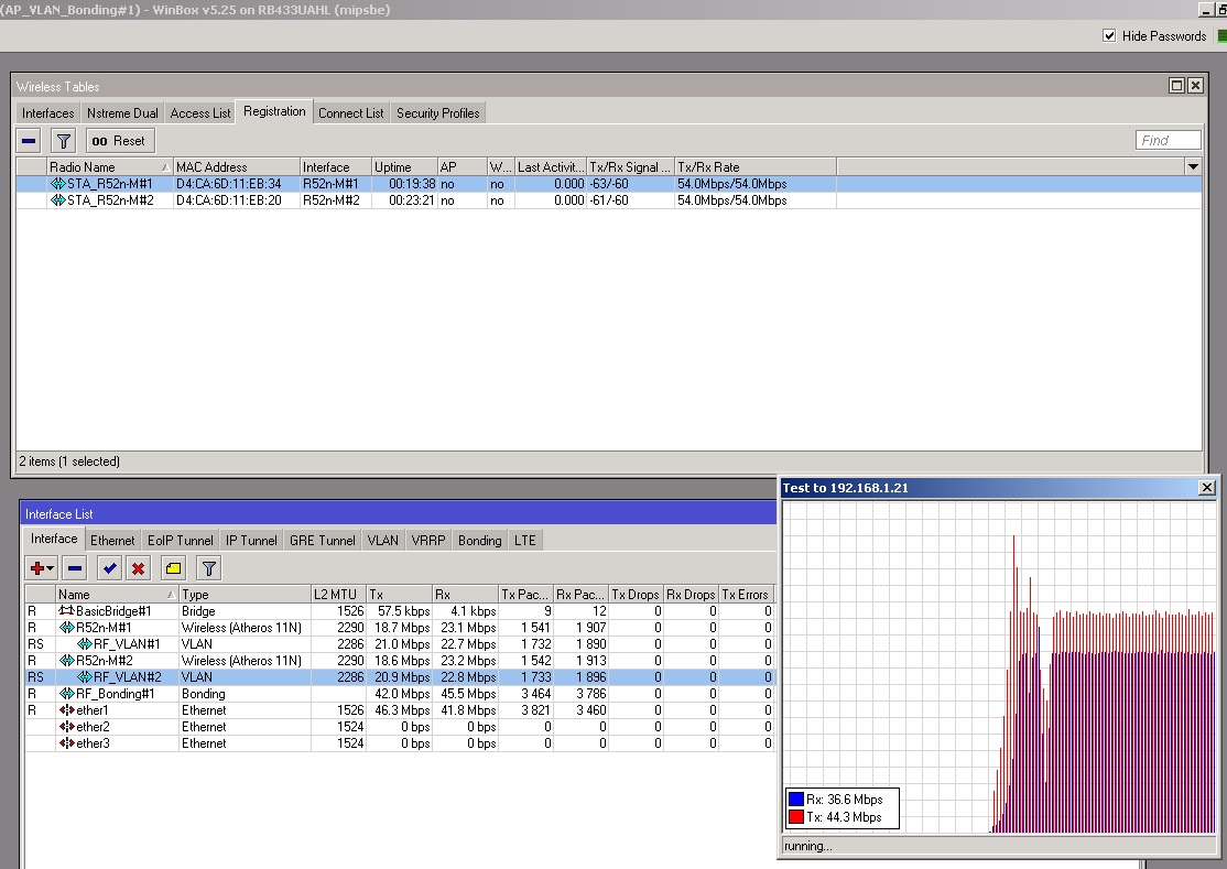

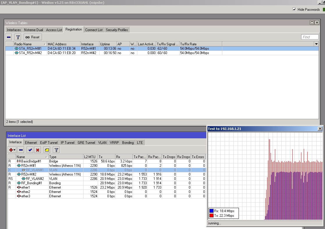

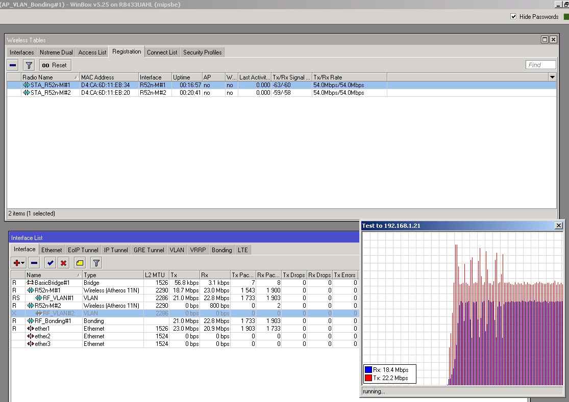

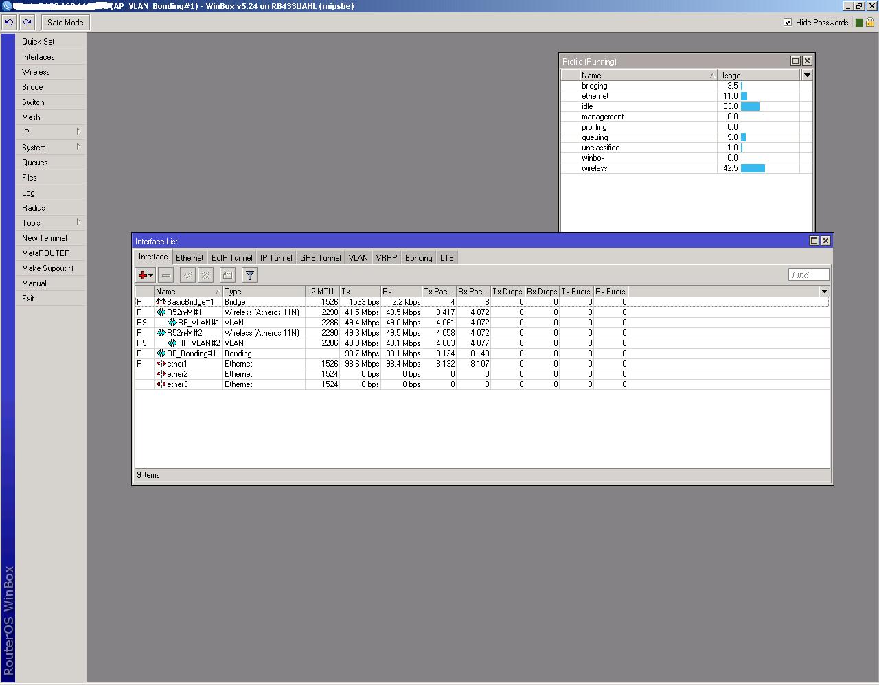

I have no XR5 but I set ‘A’ band on R52n-M and use only one chain.
Test throughput using first leg only:
Test throughput using second leg only:
Summarize throughput using both leg:
ROS v5.25 is used.
