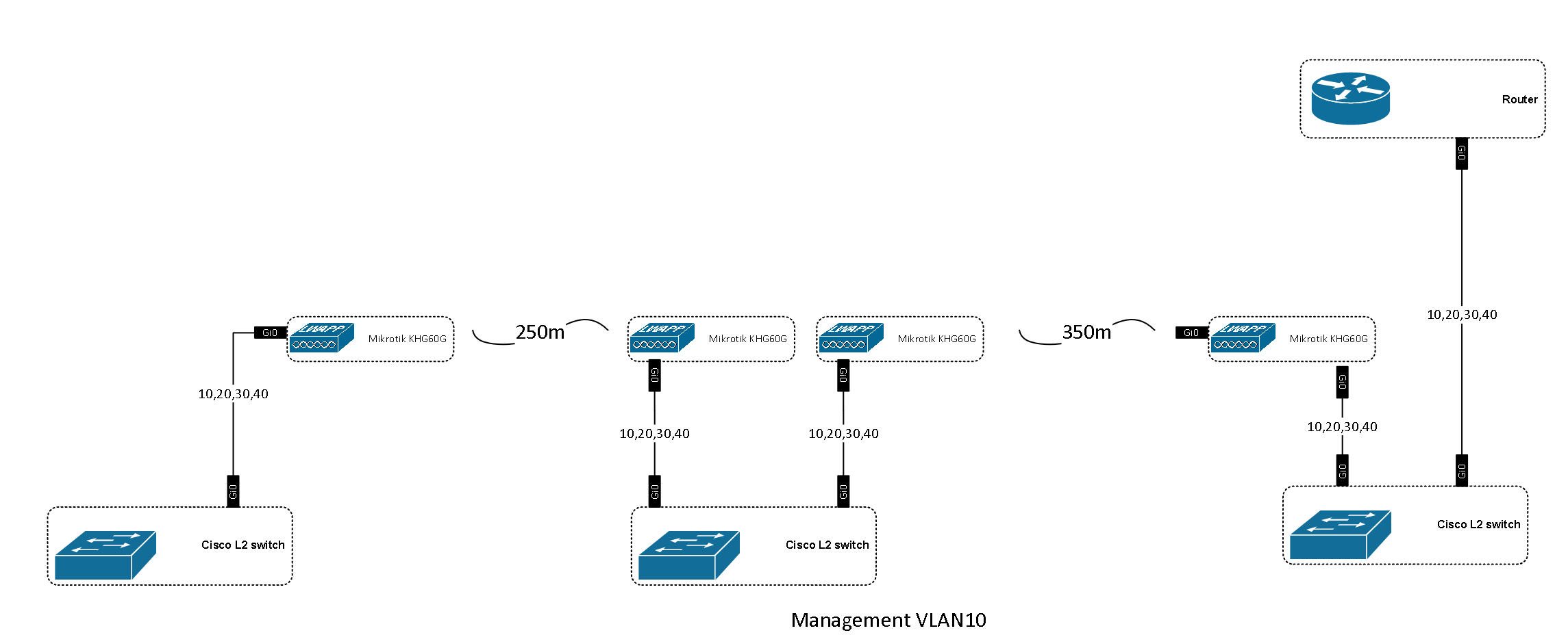

Firstly I have zero experience with Mikrotik products and been asked to try and assist a customer who have bought these themselves and tried to install however, they themselves are unsure on how to configure them properly.
The topology I I believe looks like the attached. Is there any configuration templates that would make this work? Any other considerations to be made aware of?
Nothing to configure (except passwords, etc.) , are already configured out-of-the box.
Treats the two pairs of Wireless Wire Dish RBLHGG-60ad simply like an ethernet cable.
Thanks. So out the box no Master/ Slave type selection pairing needs to be done between points? how does that work? do they join a default SSID, using default username and password? all configurable later? Do they accept all vlans passed to them without defining them on these devices? Sounds too good to be true…
Yes it is so good .
The devices come paired. At least in the CUBE “wireless wire” package: https://mikrotik.com/product/wireless_wire_cube
(SSID and passwords are set on both for 60 and 5 GHz) [and printed on the outside, so that are the first things I change]
(The 60G and 5G fallback link are bonded for fast failover in the default setup.)
What is the KHG60G MT device ?
I use these CUBEs with RB260GSP (SwOS) or Powerbox Pro (ROS) as interconnect for the proper PoE injection in the CUBEs and other MT devices. MT PoE might be incompatible with Cisco PoE.
Playing “dump” switch in all devices no VLAN settings are needed, everything will be forwarded. For multipoint connections, management VLAN, and smart traffic reduction, then VLAN settings in the interconnect (and eventually in the CUBEs if needed) will help.
My mistake these are apparently LHG60G (https://mikrotik.com/product/lhg_60g).
https://mikrotik.com/product/wireless_wire_dish
These come pre-paired from the factor with a unique SSID and password. There is an included label with each device that notes it’s role of Master or Slave and the password. The individual devices are the same LHG-60G that you can purchase individually and are not pre-configured.

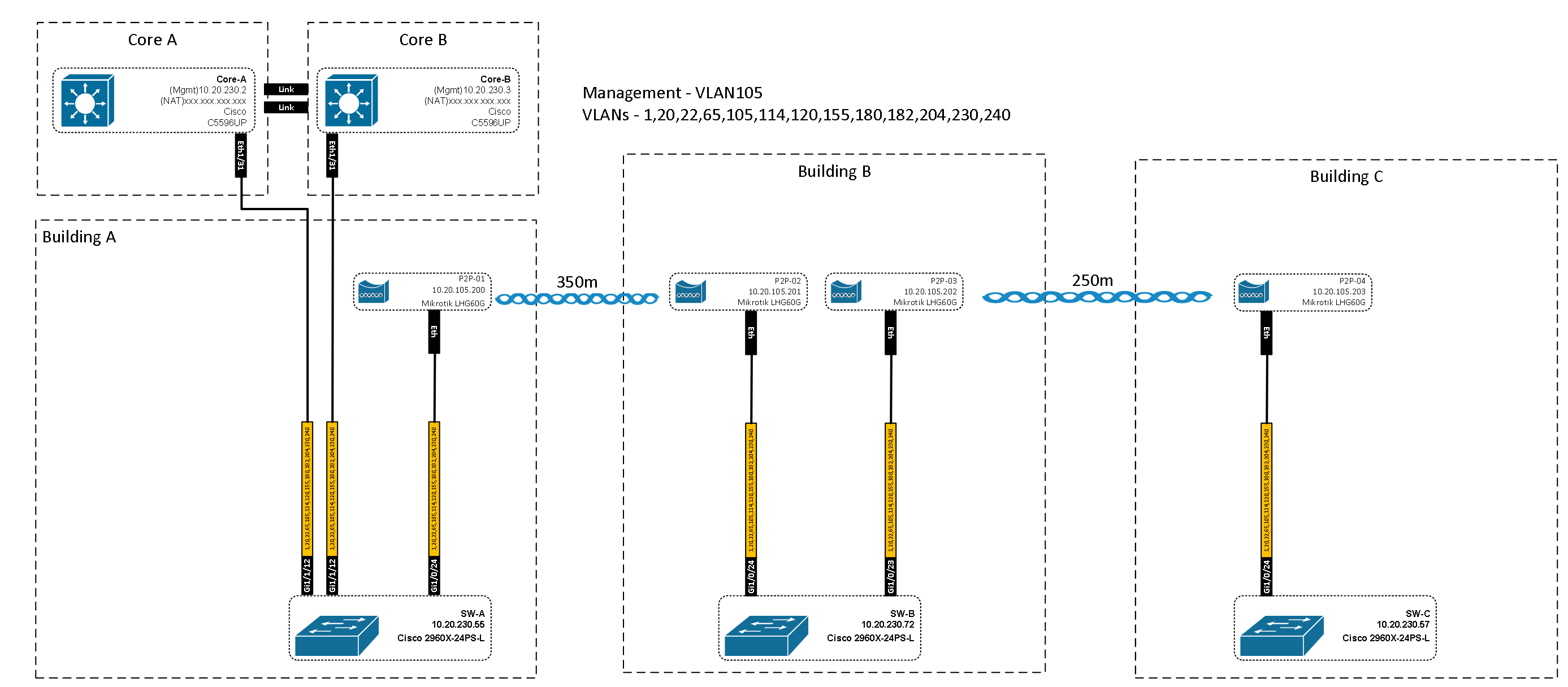

I have received current config files and a little more info. Not much on there.
I have tried a notepad++ compare mikrotik config and found that P2P-02 does not have an ip route configured, should this be configured?
Should the management VLAN be untagged on both the SW and Mikrotik config? I believe SW-B and SW-C both have a Meraki AP hanging off them.
Customer: The main issue I was having was with devices authenticating via ISE, DHCP does not seem to be returning requests, so whilst ISE authenticated the device connection failed. If a device has a static IP and authenticates with Mac Address Bypass, the devices work.
P2P-03 and P2P-04 have not been installed/configured yet.

Switch Configs:
SW-A
interface GigabitEthernet1/0/24
 description WiFi P2P (AtoB)
 switchport trunk allowed vlan 1-20,22-114,116-4094
 switchport trunk native vlan 105
 switchport mode trunk
 no logging event link-status
 srr-queue bandwidth share 10 10 60 20
 queue-set 2
 priority-queue out
 no snmp trap link-status
 mls qos cos 2
 mls qos trust cos
 spanning-tree portfast edge
 spanning-tree bpduguard disable
SW-B
interface GigabitEthernet0/1
 description Wireless P2P(Building B to Building A)
 queue-set 2
 priority-queue out
 mls qos cos 2
 mls qos trust cos
 ip dhcp snooping trust
 SW-C
 interface GigabitEthernet1/0/1
 description description Wireless P2P (Building C to B)
 switchport nonegotiate
 priority-queue out
 mls qos cos 2
 mls qos trust cos
