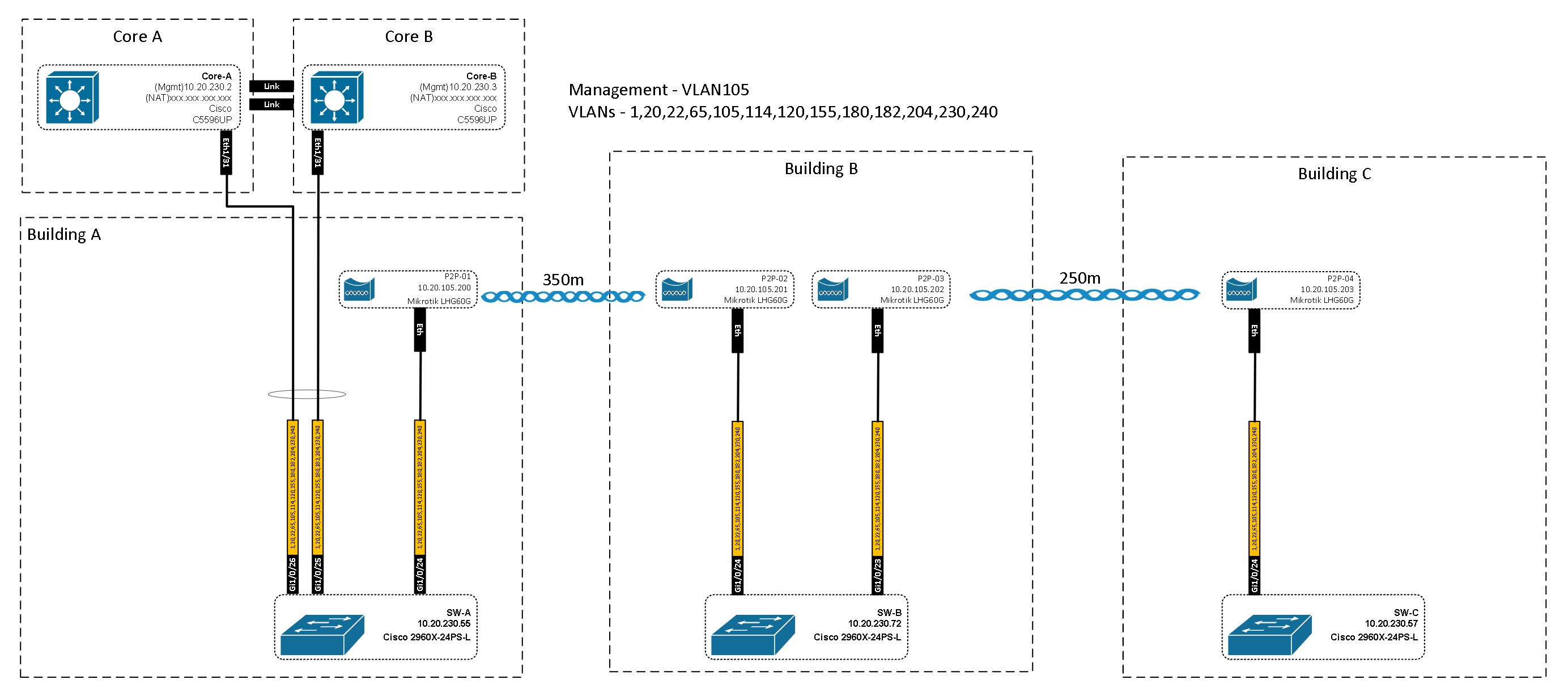

Firstly I have zero experience with Mikrotik products and been asked to try and assist a customer who have bought these themselves and tried to install however, they themselves are unsure on how to configure them properly.
I have received current config files and a little more info. Not much on there.
I have tried a notepad++ compare mikrotik config and found that P2P-02 does not have an ip route configured, should this be configured?
Should the management VLAN be untagged on both the SW and Mikrotik config? I believe SW-B and SW-C both have a Meraki AP hanging off them.
Customer:
The main issue I was having was with devices authenticating via ISE, DHCP does not seem to be returning requests, so whilst ISE authenticated the device connection failed. If a device has a static IP and authenticates with Mac Address Bypass, the devices work.
P2P-03 and P2P-04 have not been installed/configured yet.
Although their main issue seems to be dhcp related, however, I would like to rule out the Mikrotik configuration and ensure good practices are implemented..
