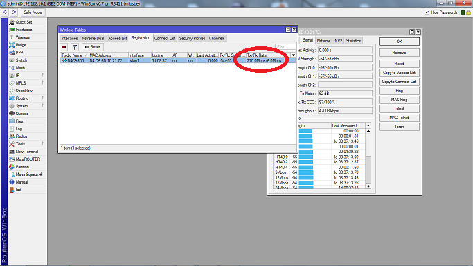

Hello, I have a wireless link over 2km. Board RB411, Card R52hn, an dualpolarized Flatantenna with 21dbi on both sites the same hardware.
The problem is the following…
See the graphics:
First time tx/rx rate 300Mbs/270Mbs
one second later 300Mbs/6Mbs
and this change all the time.
So there is my actual config:

The real transferrate is only 23Mbs, is too slow… and I think, i have a problem, but i dont know, whats the problem.
Please help
Thank you
Try this settings
http://www.wirelessinfo.be/index.php/mikrotik/pages/omnitikpp
Its with other device but is the same configuration
Great,… thank you it solves the problem
Thank you very much
