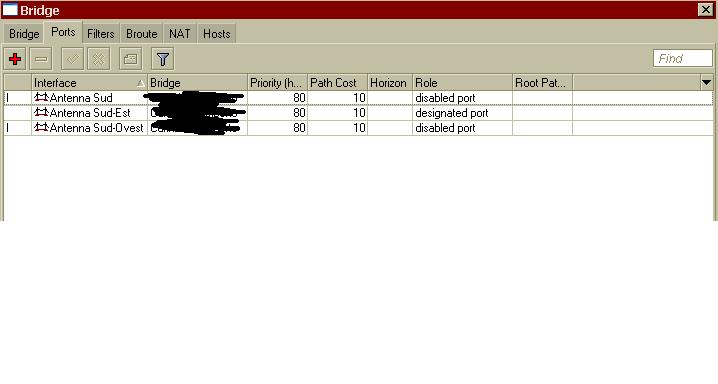

Good morning,
I have a Mikrotik Software 3.2 on x86 equipped with 3 R52H, and I would realize a single Access Point with 3 antennas at 2,4Ghz.
I thought that the best way was to declare a bridge interface to which associate all three antennas, but my problem is that two of the three bridge port go on disable state.
This is the configuration:

Question:
  1. is this the correct design?
  2. is this the correct configuration?
  3. using the same frequencies for all antennas is there any interferences that could degrade the signal?
Best Regards,
Alessio

Hi alessio-
Try associating a client with your two new radios. The bridge ports should go active.
Dear
nothing worng with u’r gonfiguration
in 3.x the wireless interface dosn’t go forwording where is no associated clients.
