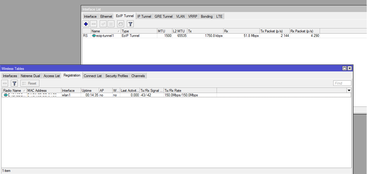

Hi i am using the following tutorial to bridge two networks: http://wiki.mikrotik.com/wiki/Transparently_Bridge_two_Networks_without_using_WDS_(EoIP)
Currently i am testing in the same room with 10 metres separation between 2 grooves, I am using nv2 protocol, band 2Ghz-N only, 2GHz antennas, 20MHz/40MHz Up channel width, and the cleanest channel that i scanned for.
My registration shows the other access point at 150Mbps/150Mbps Tx/Rx rate, but actual throughput i am getting through on file transfers is 5.6MB/s (~45Mb/s). I know there is some overhead for protocols, but 45 is very different from 150.
This is the first link i have ever done, so not sure what to expect. Is this normal? Can this transfer rate be increased?
Appreciate comments, help and pointers.
Try to decrease power to have a signal around -60 dbm and check CCQ.
Configure bridge, station-bridge mode, VLANs or MPLS tunnels, EOIP is havy for processing.
Generate and receive your packets from routers behinds your wireless devices, it will increase… but don’t expect mo than 99 Mbps, you have a 100 mpbs network card on grooves :slight_smile:

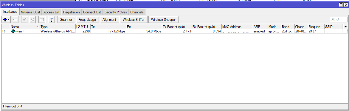

Thanks for the reply, OK so now I am using bridge with station-bridge mode for wifi, and just bridging in the wireless+ethernet on each mikrotik.
I set the tx power on both so that tx/rx signal is around -60dB.
The speed is now 55Mbps so a 10Mbps improvement from before, I notice the CPU usage is running at 30% (probably to be expected with these boards for this excellent price point!).

You can find the CCQ clicking on the line in registration tab… TX/RX CCQ
