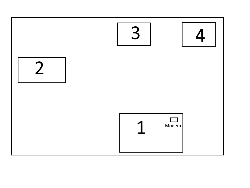

I would need to connect internet to 3 buildings from the main building wireless.
The buildings are about 50m away from the main building.
Which MikroTik devices would be suitable to connect them?
All buildings are in direct sight.
