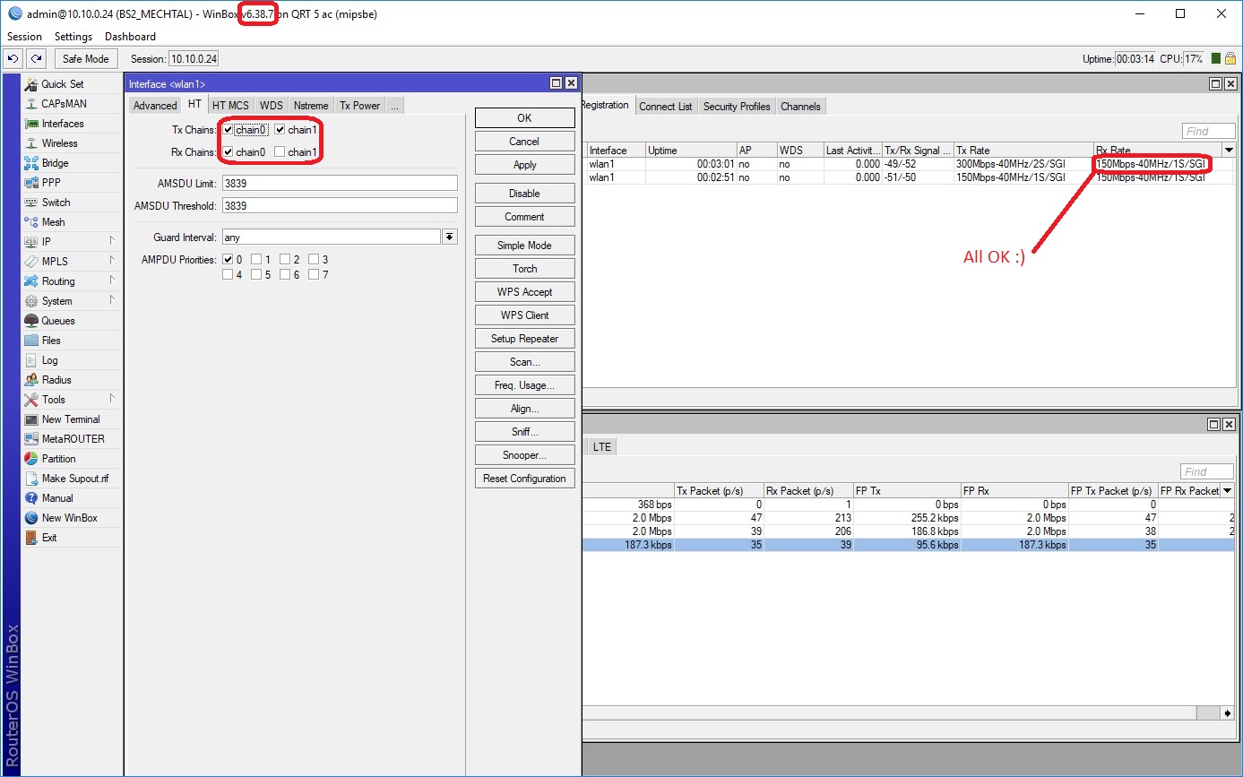

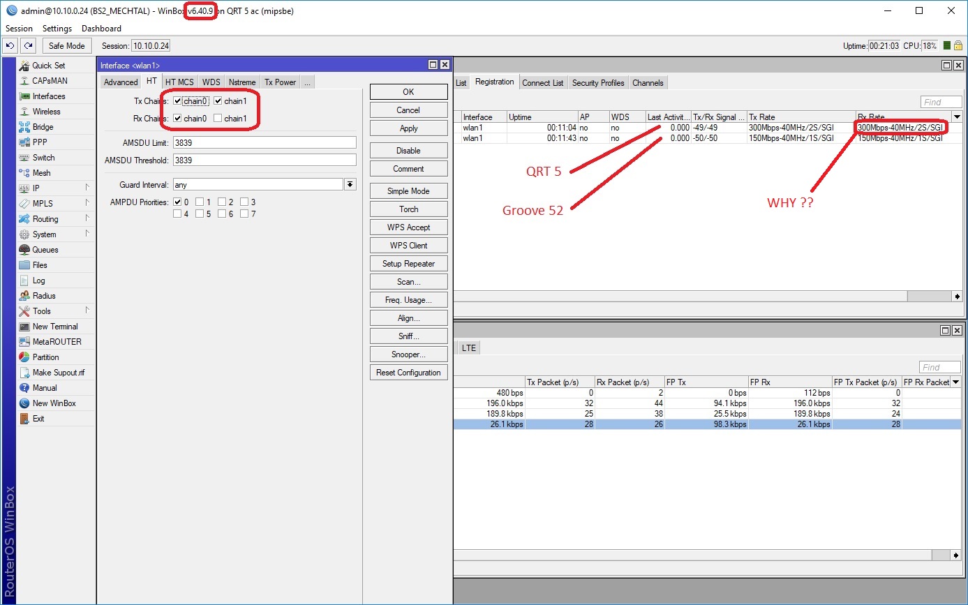

I recently upgraded APs in all my BS stations (6.38.7 → 6.40.9) and noticed that I lost possibility to disable HT RX Chains (I can uncheck chains but it does not work - see attached screenshots).

I have made more detailed tests in “sector” where only I and my neighbor are connected (so our dedicated “sector” is based on QRT 5 ac, 3 km away :slight_smile: ) - the problem exists also in 6.39.3 (bugfix). Latest bugfix release without this issue is 6.38.7

I have updated it anyway, but described above issue still exists in v6.42.9 (long-term) and even v6.43.4 (stable) :frowning: :confused:
Tried with 802.11, NV2 and nstreme - same behavior in all cases - can’t successfully disable a Rx chain on AP side despite unchecking :frowning:
