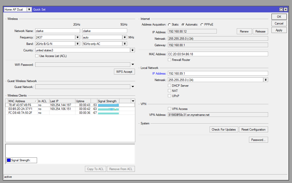

Hello. I have a hEX successfully serving wired clients, and a cAP AC plugged into it. After a reconfiguration, wifi clients can’t get an IP address. I was using CAPsMAN months ago but reset everything and am just setting up the cAP directly now as I only have one. My devices can see the wifi network but can’t get an IP on that network.
For the cAP I used Quick Set with “Home AP Dual”. There are things wrong here but I’m not sure how to fix them. It got 192.168.88.12 from the hEX, but for some reason still wants an IP address under “Local Network”. I’m not sure why. 0.0.0.0 is default there but I can’t save things with that setting. I added 192.168.89.1 and that was allowed, but I know it can’t be right as I have DHCP turned off anyway on the cAP. See the screenshot.
Also I see my wireless clients are connecting, and keep getting 169.254.x.x addresses assigned to them briefly before the addresses disappear. In the end it seems (?) like my hEX DHCP is not assigning IPs to wireless clients connecting via the cAP.
Use “WISP AP” and set bridge mode. “Home AP Dual” is intended if you have the device hooked up directly to your WAN.
