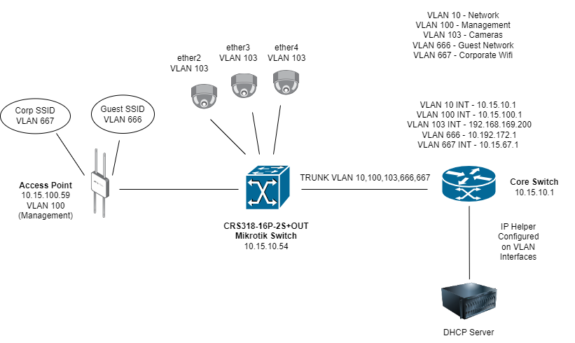

I’m new to RouterOS and Mikrotik hardware. After a lot of research and testing I have almost everything working on a CRS318-16P switch besides for the wireless clients who can’t obtain an IP address through their assigned VLAN on the bridge.
Things that are working, the camera plugged into ether2 on VLAN_103 works fine. The wireless controller can see the AP and communicate with it on VLAN_100. I can communicate and manage the switch through the Trunk on VLAN_10 fine. The only thing that’s not working is the two SSID’s on which are on VLAN_666 and VLAN_667, when trying to connect to those networks I cannot pull an IP address from the remote DHCP server.
I have over 50 APs running through other switches (mainly Cisco) without issue, so I know the setup beyond the Mikrotik switch is setup correctly and working fine. This is just my first rodeo with RouterOS and it’s throwing me for a loop.
Attached is a basic diagram layout of what I’m trying to do and a copy of the config is below.
