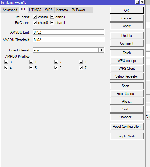

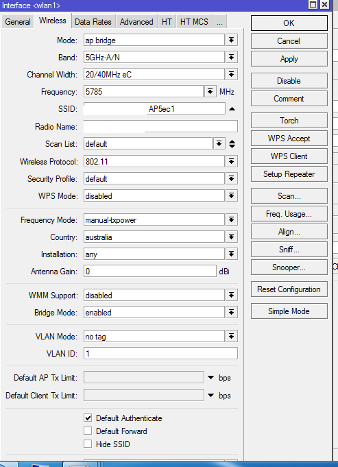

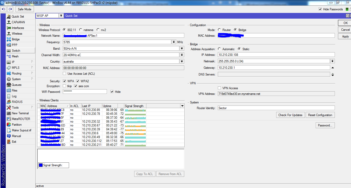

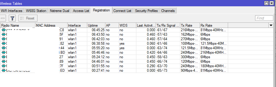

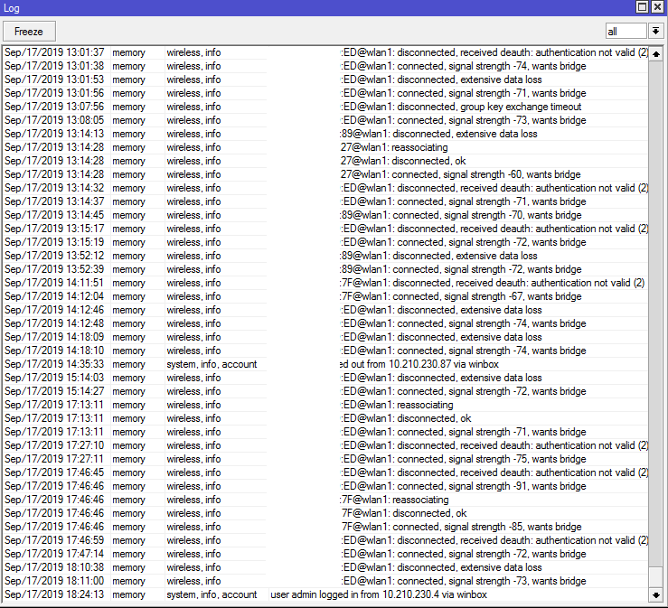

Hi mikrotik expert,I am using mikrotik sector 120 mantbox, Ther are only 10-12 clients connected with good signals still high latency with the packet loss of all clients together. Plz see the screenshots and help me.

You Clients have Bad Signals, everything under -65 is real bad
ubnt clients also connected to the same AP, so using 802.11.

-65 isn’t that great, in many clients scenario weakest clients slow everyone down.
Also check the SNR, not just absolute signal level (and the noise floor). There might be some interference on the channel causing errors and client disconnects…
