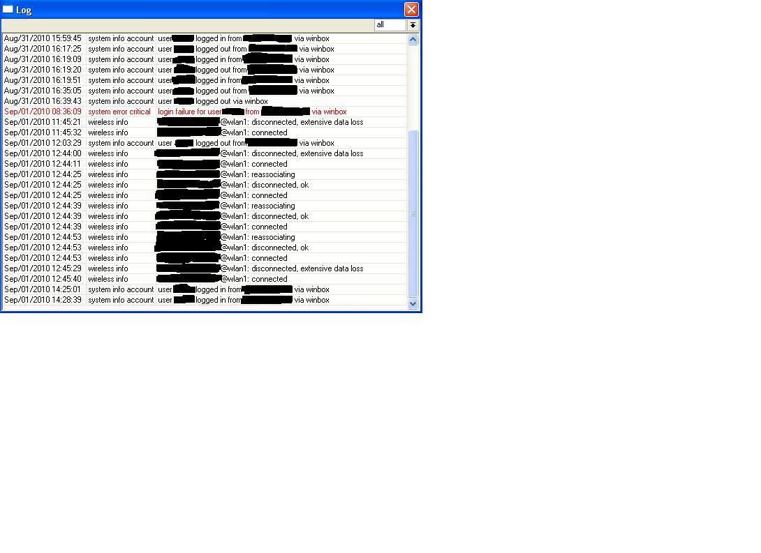

I have got a wireless link within my network. When i check log entries on my router board, i could see the connection being disconnected and connected very oftenly. Some times it happens within the same second and some times it takes 12-15 seconds to reconnected. I have attached the log entry picture as well. Can anyone tell me what that could be?
How is the signal strength on that connection? “extensive data loss” usually means the signal is weak. It might help if you post “/interface wireless registration-table”.
