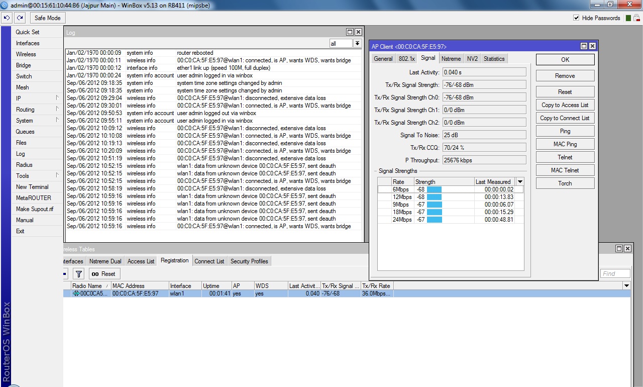

Can you probe the signal strength and post the graph here…
Sent from my HTC Incredible S using Tapatalk 2
Check this

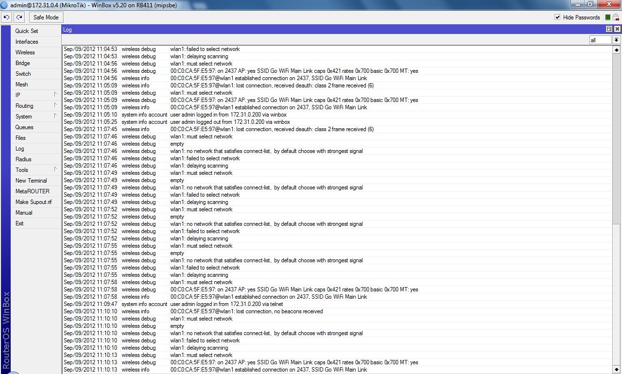

i am getting error no beacons received now
i changed the protocol to nv2 and the link is stable now but the throughput is only 4Mbps

  1. from the picture I can see that your signal levels are -76/-68 dBm. The -76dBm is quite low for reliable link. When I put your params (30dBm TX, 24dBm antenna gain, 14000m distance) into link calculator I get -48dBm of receive level. So if you have antennas connected with short cables (or even via pigtail only) to the radios you have something terribly wrong with the link.
  2. the 30dBm cards looks like an overkill. We have an experience that the RB4xx have troubles with high power cards which cause the box restarts with no obvious reason (maybe the power source module on the board is not able to deliver enough power for the card and the board). And we observe this with DBII cards which should have about 24dBm max TX power. The problem seems to manifest more when you are using low voltage power supply (12V battery backup and so) but we observe it even on 27V.
  3. I woulndn’t expect much support from Mikrotik for ‘non official’ wifi card (Alfa card)
IMHO you should check you devices why there is only -76/-68 (the 8 dBm difference is too much too - if there is no reason for it). Then you should check both RB if there are no unexpected restarts (check uptime, check first lines of the log) related to link disconnects. If you solve the problem with the bad signal then you can lower your TX power (which could eliminate restarts if you have any) or even you can use standard wifi card (made by Mikrotik).
