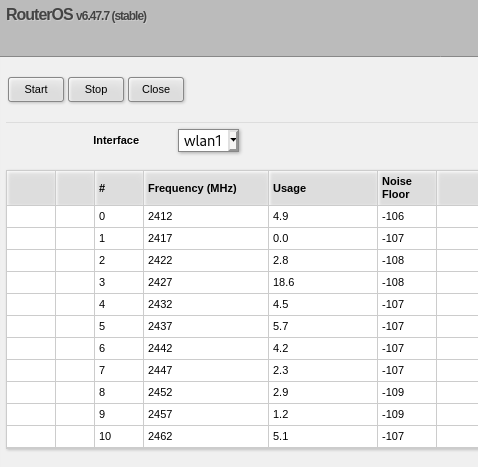

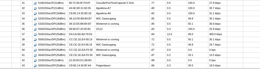

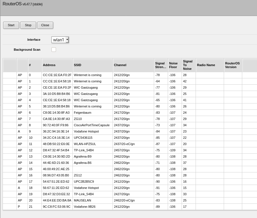

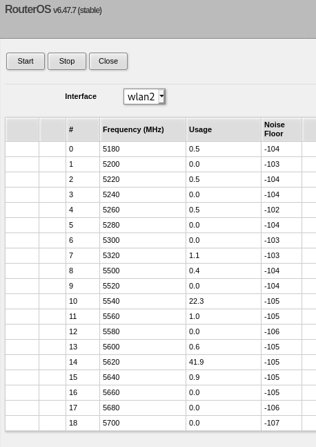

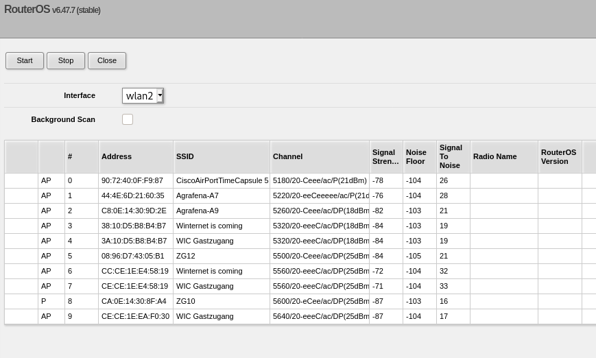

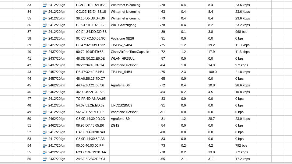

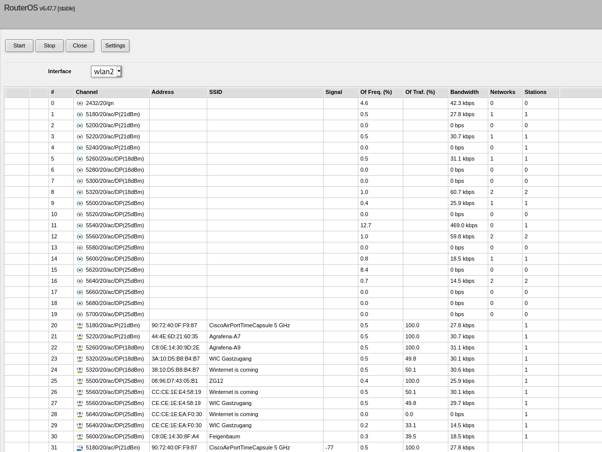

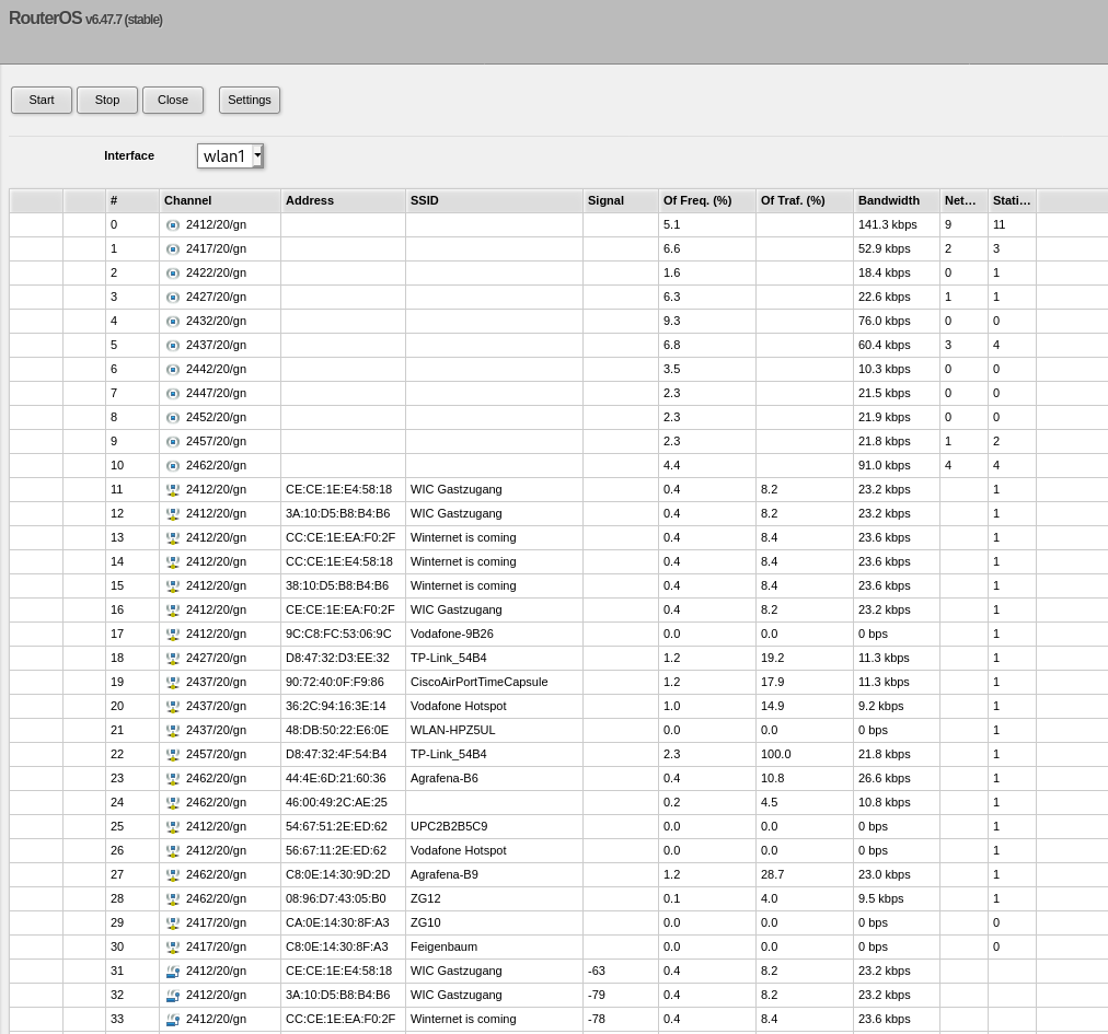

i did the tools “scan”, “Freq usage” and “Snooper” on both wireless intefaces. The results will be attached as images (png).
The other things /export and registration-table attached as text files.
I don’t change any thing right now. First want to have a detailed look at the results from the above tools.
But if you have a proposal i will be happy.

Interesting study case for wifi training, but not so easy to pick the best setting. A real life case.
First some general principles:
  • This one shot information is what “auto” uses to pick a channel. The one that picked channel 4 is just an example of this, not considering any interference it causes. Of course the selection should be made based on multiple observations, and maybe even on the worst case scenario.
  • There are a lot of competing wifi devices around. The modern chip-sets with a noise-floor of -108dBm make it worse than older chipsets. We will wait for everything above 6 dBm above the noise floor. And if there are slow connections, we will wait a lot. Freq usage indicates not too much traffic at that single moment of observation, but this can change rapidly.
  • It is well known that 2.4 GHz is often overcrowded. And that’s somewhat the case here. So 40 MHz (wait for 8 consecutive free channels) is not the way to set this up. 20 MHz should be the bandwidth.
  • 5GHz is cleaner. And if you can move there with your client device, that is the way to go. Even with 40 MHz bandwidth. 5680-5700 is actually free in 5 GHz. Not sure the client device can work with that freq.
  • Your client device only connected with 1 stream/path/chain, as indicated by 1S in the registration. Either the client device is single stream, or the signal interference reduces the possibility to use 2 chains. This halves the potential interface rate. 3 chains is the possibility for the hAP ac, but not many client devices can do this.
  • Missed channel 12 and 13 in the 2.4 GHz band. But you have “no-country-set”, so you follow the FCC regulation with channels 1 to 11. This “no-country-set” allowed also for the illegal “antennagain =0”. The real antenna gain for 2.4GHz is 3dBi, to be set (this will reduce the radio power with 3 dBm to make it legal in Europe), but it will also add channel 12 and 13. The AP transmission power is not the limiting factor. A client device has usually a weaker signal.

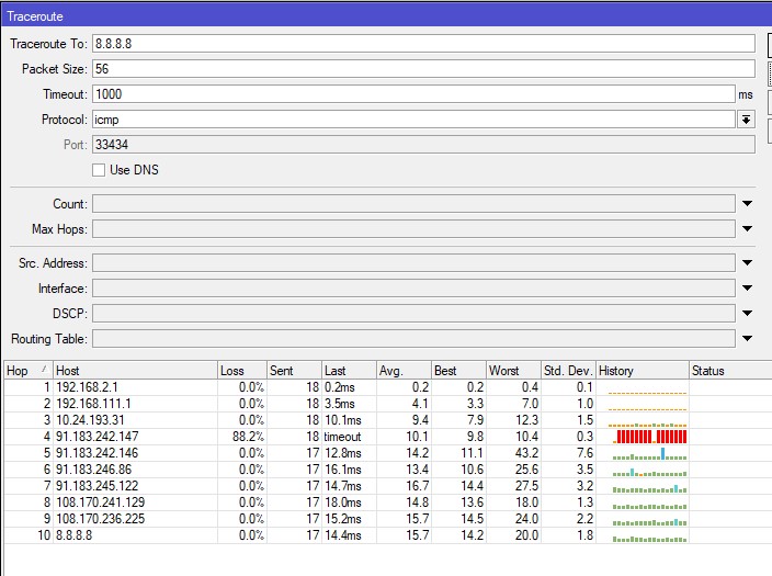

I think it’s rather some overlooked config or cable mismatch or major wifi interference. Lets take it step by step, to see where the bottleneck sits. It’s sometimes in an unexpected corner.
If you use the Mikrotik tool “Traceroute” to the same test server during that internet test, where does the largest timeout occur? (Some routers might not respond at all however.)
Simple test is traceroute to 8.8.8.8 …
