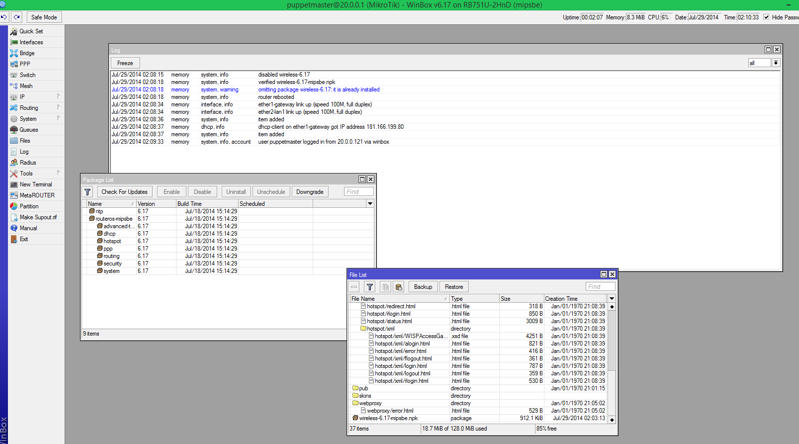

Here a screenshot… there might be a problem with the factory (inside) name of this package. Can anyone confirm?

The package is not installed… look the other windows you see there is no wireless nor wireless-fp packages installed and after rebooting tryig to install it, gives the log error about that is already installed…

I know it is not installed. But it is in your Files list. anything that is in the files list will try to be installed upon reboot. Remove it please.

What sebadamus is trying to say (As I read it) is that you would suspect that the package would be installed because its package is uploaded to the routerboard.
But the log file clearly indicates it could not get installed because it is already installed. Which in turn is clearly not the case if you look at the packages list in the screenshot.

Normis, I also did what you told… I remove the package from files list, reboot… then there is absolutely no wireless, nor wireless-fp installed! so then if I copy the wireless package to the router, and then reboot… the problem I told reapears.
