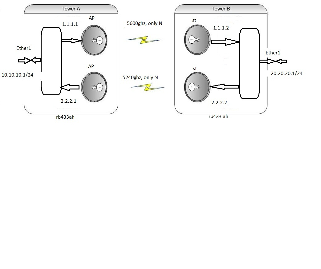

i've made another lab , and try to simulate full duplex using just simple static routing..

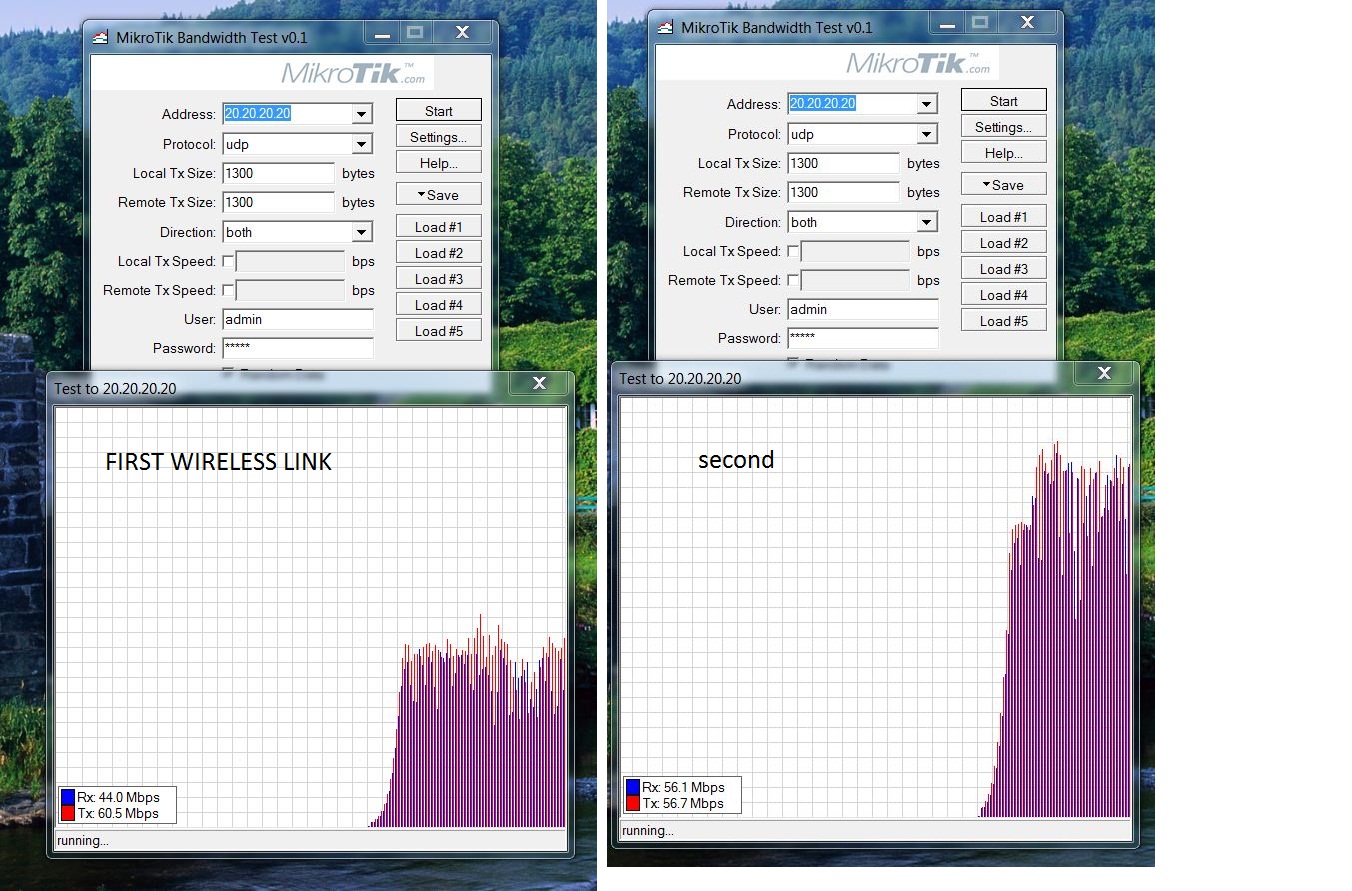

I connected two leptops, with 100mb ethernet nics on the both end of topology and run BT server.
these are BT results without full duplex simulation..
you see that i have aproximately 50mbs full duplex per link..

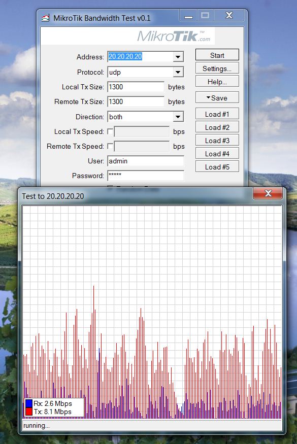

Now i'm gonna show you BT results with sumulation full duplex using simple static routing.
The configuration is :
TOWER A:
DST-ADDRESS PREF-SRC GATEWAY DISTANCE
0 ADC 1.1.1.0/24 1.1.1.1 wlan1 0
1 ADC 2.2.2.0/24 2.2.2.1 wlan2 0
2 ADC 10.10.10.0/24 10.10.10.1 ether1 0
3 A S 20.20.20.0/24 1.1.1.2 1
TOWER B:
0 ADC 1.1.1.0/24 1.1.1.2 wlan1 0
1 ADC 2.2.2.0/24 2.2.2.2 wlan2 0
2 A S 10.10.10.0/24 2.2.2.1 1
3 ADC 20.20.20.0/24 20.20.20.1 ether1 0
and BT test result:
these results are terrible...
help me solve this problem , or just say that full duplex simulation doesn't works... vaax gavgijdebi raaaa :question: :question: :question:

i’ve tried it… i launched two BT from each leptop (udp, send) and results were terrible…
i think there is no interference between radios, because they are operating in different frequencies (see topology )…
p.s i also tried that topology using two rb433 per site, but results were same…
Is this bonding of two N links?
On u’r second picture with the result of 2 tests on both picture btest is made to 20.20.20.20?
the test should be like from 2.2.2.1<->2.2.2.2 and 1.1.1.1<->1.1.1.2

it is not bonding, just AP—>station
20.20.20.20 is the ip address of second leptop on the other side… i’m testing through the routers.. it shows more realistic results…
