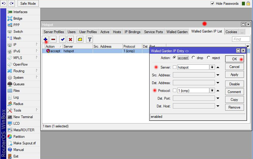

Go to “walled garden IP list”
Klik on the blue cross
Do what you see in printscreen (by server stand hotspot you must set to bridge from hotspot)
This will make you can ping to the hotspot.
To login with winbox you will first need to log in to the hotspot
