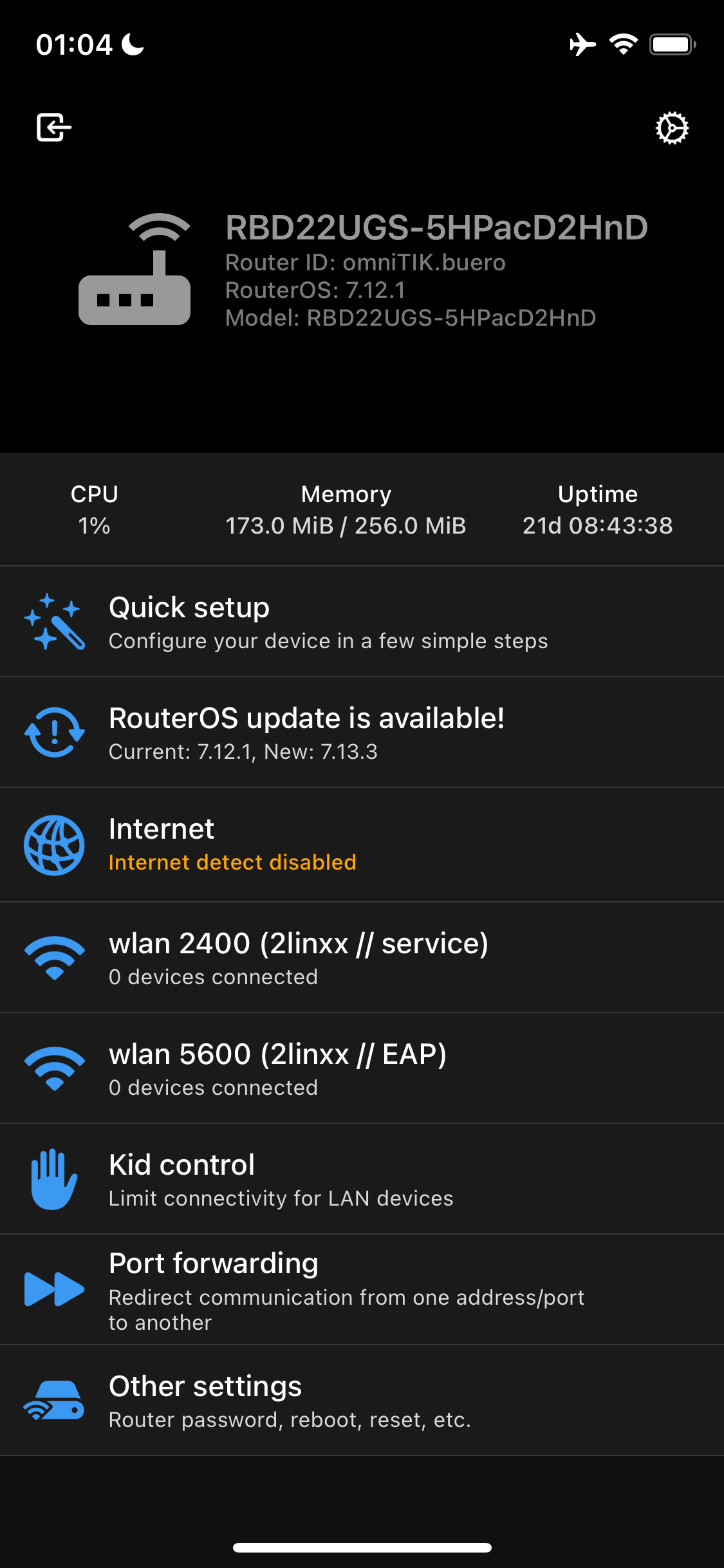

I am using 7.13 on a ax3 en ac2 the app works fine for the ax3. The wifi info does show in the main screen of the app for the ac2. But the detail wifi Information does not show any data for the ac2. App version iOS 1.2.13.

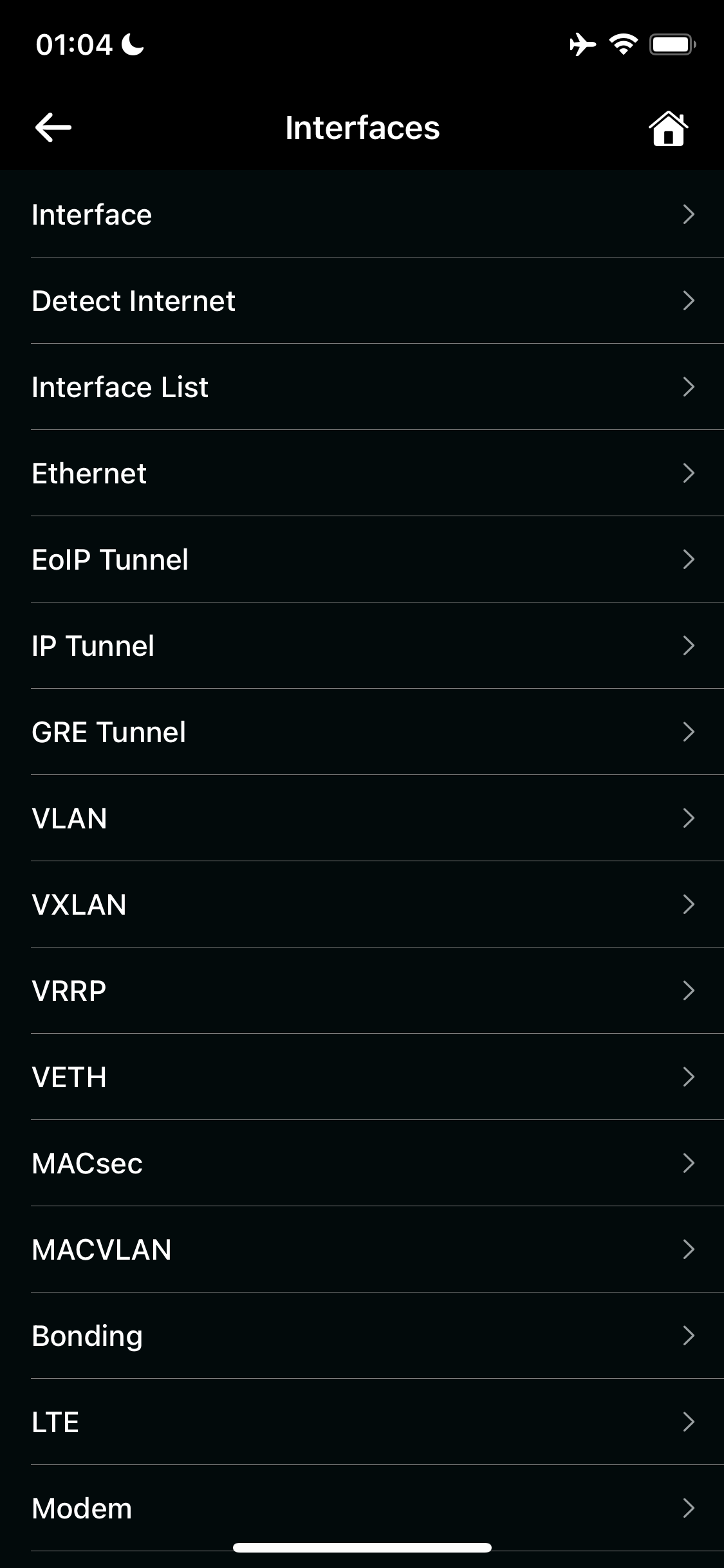

In previous versions, you’d be able to click on the wifi interface in the Home Screen of iOS app, and the gear icon in upper-right would show wireless settings. That’s blank now.

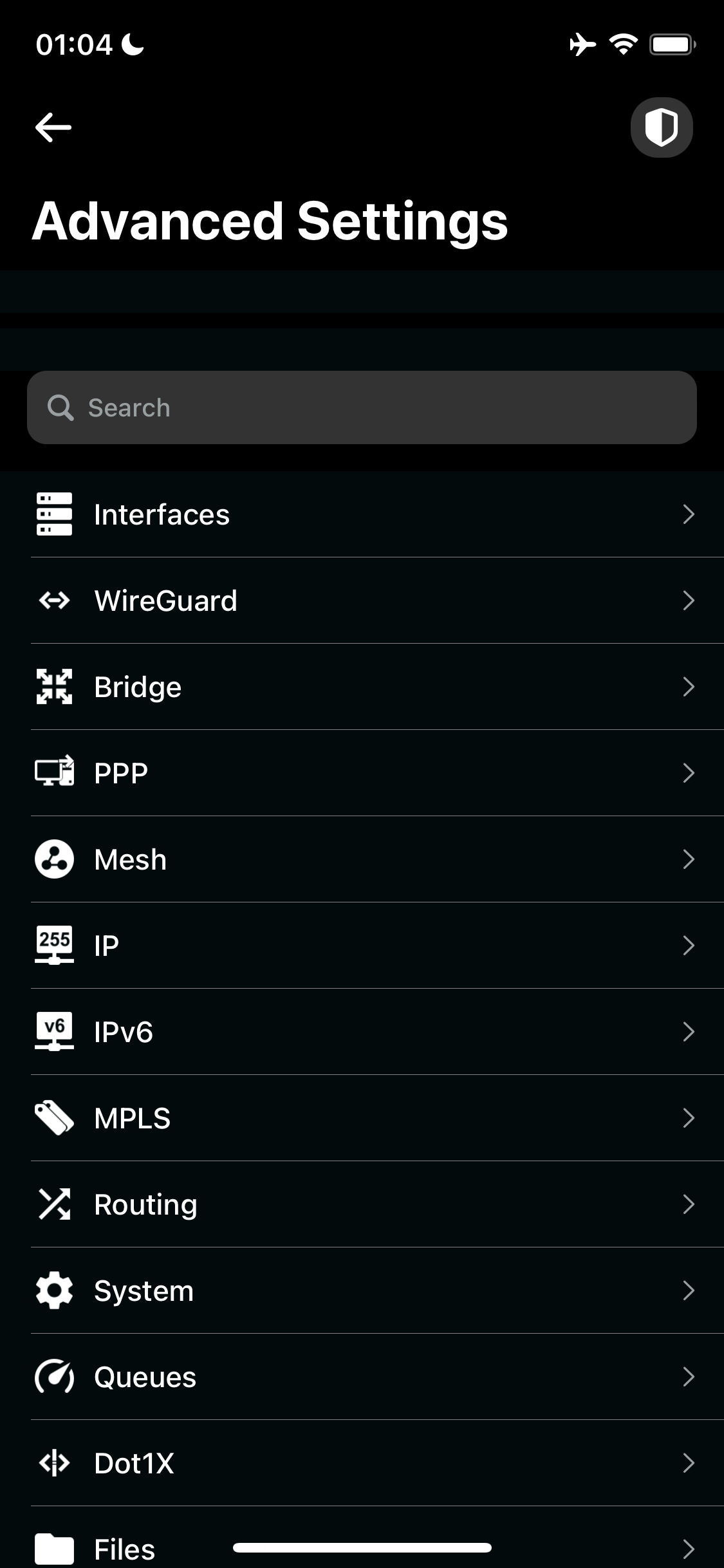

And in the “Advanced” menu, in 7.12 the wifi (wlan) interface do not show up at all, either in the main interface list nor in “Wireless”. In 7.13 and 7.14beta, the WiFi menu (for AX CAPsMAN) appears, but since “classic” drivers no interface there & no “Wireless > Wireless” menu at all.
