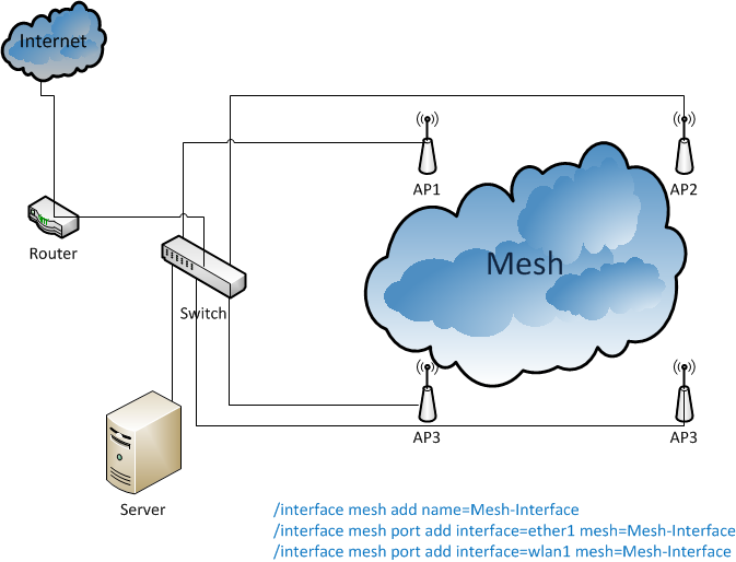

I tried to create a mesh network but using my eth1 port:
                         /-- RB751
Server ---- LAN -- Switch --  RB751
                         \-- RB751
I need a mesh cloud in my warehouse.
I created mesh interface with eth1+wlan1.
Ip is on mesh interface. When I done this on the second RB I lost access to the firs RB751.
Why mesh not working with ethernet port ?
Thanks.
Looking at your diagram, all access points are wired to the switch - where does mesh fit in then?
Problematic example 1: Ethernet switch inside a mesh
TheWiFiGuy I can’t use wired interfaces to transport mesh traffic ?
HWMP+ help please
Wireless WDS setup, cannot see LAN network ..
I can’t see why you need Mesh.
Just set up each wired node as an access point, running the same ssid on a different channel - assuming all access points are running on the same network which your diagrams kind of suggests it is.

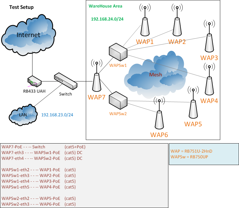

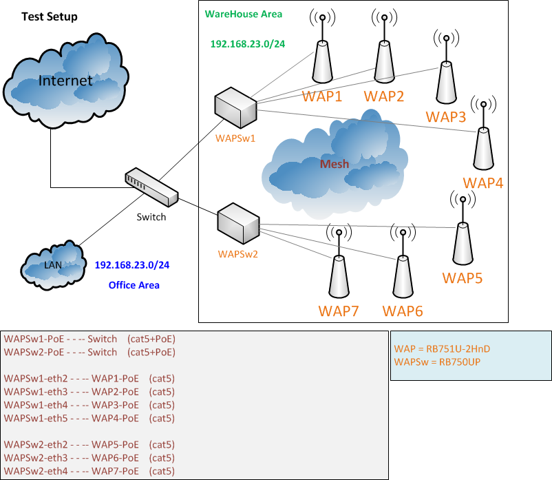

Now I have 4 AP, but in plan to by more to cover all warehouse area.
This can be done using separate L2 zone ?
i haven’t done it yet, maybe you could create wds like network and put the ether interface connected to the switch to those bridge.
jackman, maybe I will try to do this.
But in this topology I will have one point of failure.
This is my first planed topology, but as more I search the answer then more I convinced that on Mikrotik I can’t do this.
I this topology I can’t access WAP and WAPSw2 via Winbox MAC to setup them.
With last setup I can see all my 6 SSID, but should only one.
What can be wrong ?
