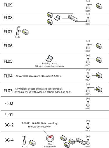

I needed to provide L2 connectivity between building automation controllers in a building that is under construction. Because the permanent network is not ready, I built a temporary wireless mesh network to allow building automation controllers to communicate. These controllers can reasonably operate on a 10 MB network so bandwidth is not a major concern. A wireless laptop also connect to the mesh network. Another goal is to allow the network to remain operational if a router or two is powered down (site is under construction).
The building is 9 stories above ground and two below grade. Here is a diagram of the installation.
I purchased 12 RBGrooveA-52HPn routers (one spare). Each was originally configured in ap-bridge mode with WDS Static Mesh using 802.11/2GHz-only-N and 20/40MHz Ce channel width.
An RB2011UiAS-2HnD-IN (R252 in attached diagram) provides Internet connectivity and acts as a VPN server providing remote access. It has no Mesh configuration. Connected via Ethernet through R111.
All routers, controllers and PCs are in the same subnet.

One example is R252 is able to ping R101 but nothing past R110. Router 111 can ping all other routers. A reboot of R101 & R110 seems to fix the problem for a while.
